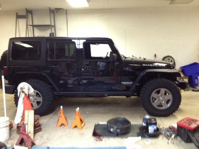

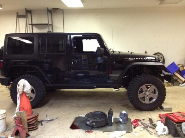

Just installed my flex system Monday. I've got a 2012 four door, hard top, and with my 35's I WILL need exhaust modifications. The front DS will hit the exhaust before full droop. Aside from my ball joints being toast, it rides great as opposed to stock suspension with 35's. This is also my DD and I foresee no issues driving it daily with the lift. Very smooth. I did not measure how much it actually lifted the Jeep, but I know it was more than 2.5"
