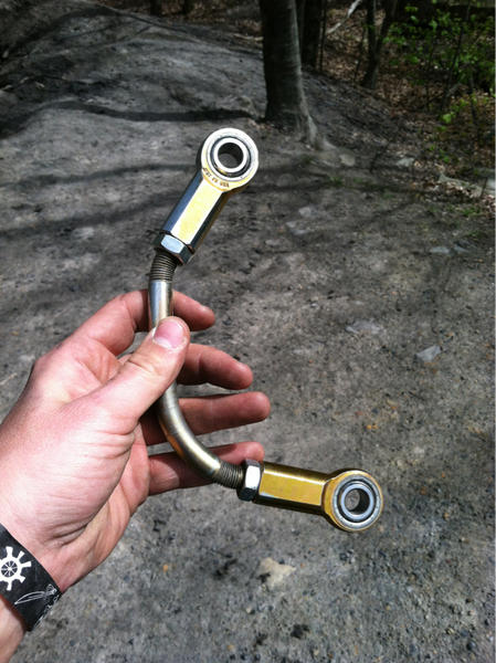

Running the sway bar level will result in this pic. (Using the e disco with 27" shocks)
I just received sway link center sections spec'ed for the 5.5" lift and they look way too long but I might try anyway and report back.

Whoah I set mine level (if I remember after all I did the lift 2 years ago) and have been @ full flex with no bendage. I gotta reassess. Nix my advice people!
