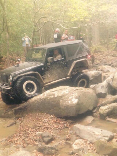

Or you can learn how to pick a good line. Just to make a point, last year I took a new stock Rubicon X through every black and red trail at Rausch Creek. Never had to winch one time. No damage to the Jeep.
My jeep had a 2.5" lift, 37s, and 14" of travel. There isn't a trail I know of that it couldn't do - probably in reverse to.
As noted, I am now finishing up my own custom designed and built suspension. Double triangulated rear with an 8" stretch, 3 link front with a 3" stretch, 16" travel ORI struts, and a flat belly (the right way to get ground clearance).

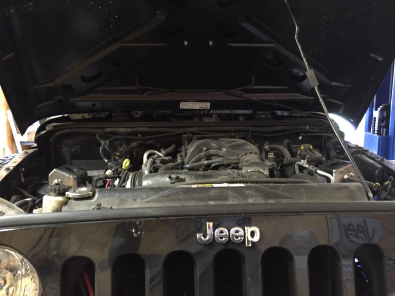

You can do less than 3.5". Try moving the mount up. You can go 16" travel without going through the hood. Close, but fits.
