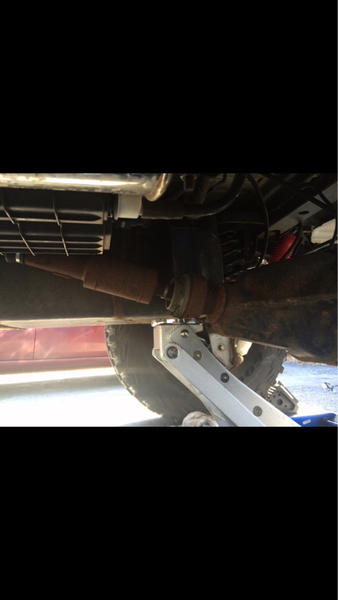

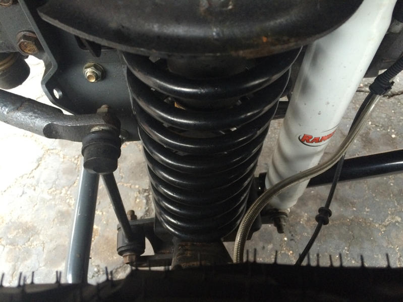

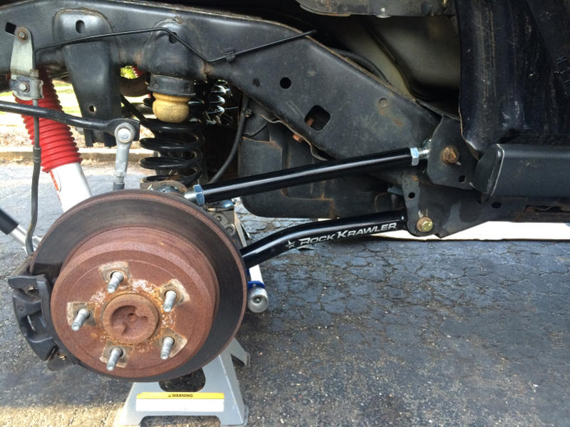

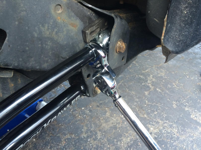

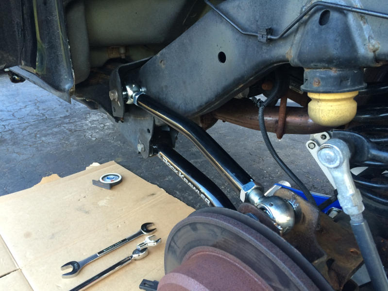

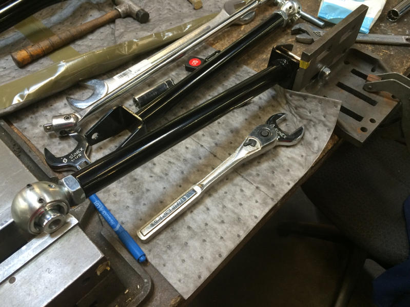

Figured I would share here on JF as well.

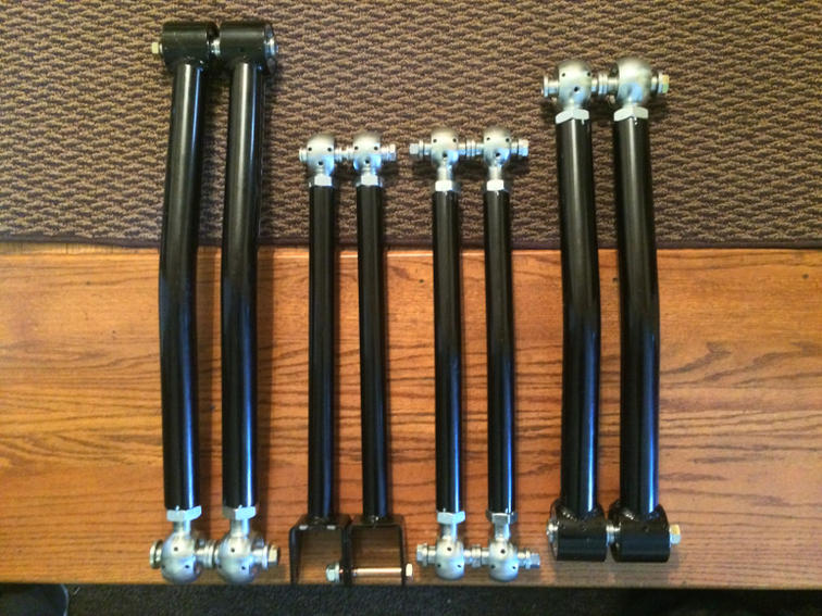

I see a lot on the forums people having issues moving the axle back 1" with the X-factor setup. Some people even swapping out to different arms or back to stock. The threads are actually tapped deep enough to cut them down if you have the means. I ordered mine shorter, seeing the issues around.
The rear lowers are slightly longer [than the max Travel lowers] and the uppers adjust down to stock + 1"-1 1/8 max.
I have a 2 door w/ 3.5" coils. The new rear lowers are set to 20 1/4 or 1/2 over stock. Uppers are set to around 18 1/2 which has my pinion -2°
The short arm rides amazing. With the new Pro series Flex Bushings NVH is kept to a min. Better then the stock arms and drop brackets I was running.
Kudos to Rock Krawler, I couldn't be happier. Pics below

Originally Posted by DunnyBunny

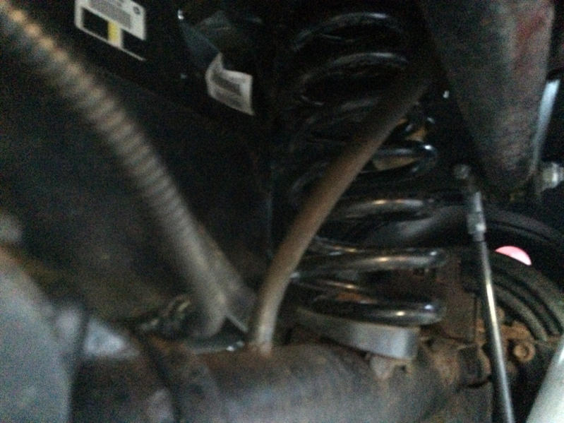

I haven't seen to many issues people are having. I have absolutely no issues with mine moved back an 1". Is it mainly a 2 door thing? I think I've seen some spring bowing with them.
Yes, coil bowing, track bar bind, swaybar links contacting stops, UCA mounts. Shock body hitting TB bracket. Mostly a 2 door thing but easily addressed with slight modifications. Some shops, people don't follow instructions and just bolt the arms up using RK's numbers. Every jeep is a little different and most likely will need fine tuning. I have the 5/16 drill and tap to move the swaybar back a little. My coils have a slight slant but look good.
My upper arms are not set to the same lengths either. Once lowers are in I placed a jack under the diff to hold where I wanted pinion angle.
Both arms adjusted out to fit the mounts. This removes any bind, bind that might have been present with the stock arms and will prolong bushing life.
