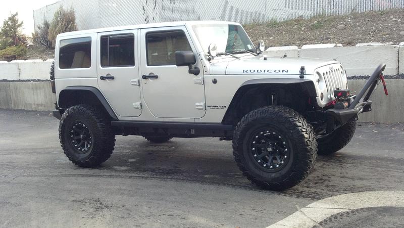

Originally Posted by Dusty11
37s on a 2.5, are you running flats and did you have to cut up anything to make it work?
I am also running a 1.25" body lift and cut my factory flares 2" bump stops front and rear tires measure out when new 36.75". My old 09 i ran 37s on a 2.5" lift but had to trim the rear wheel wells just folded over the pinch seem.
