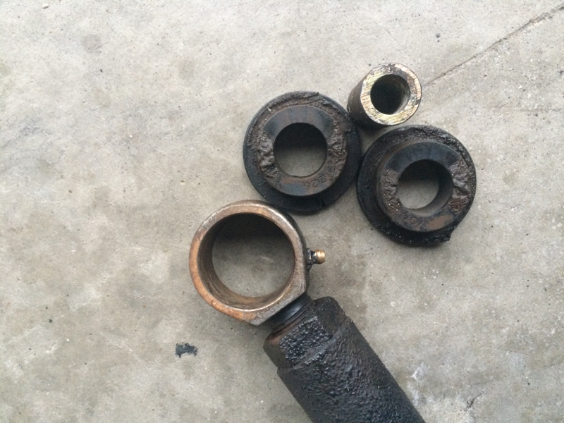

I've had my lift installed for a little of 2 years without issues. Today my wife noticed a shimmy in the front end so naturally I crawled under my jeep and noticed that the joint on my track bar was bouncing back and forth when the steering wheel is being turned.
So my question is should I just replace it with the same joint from rock krawler or go with a different setup all together?
Any input is greatly appreciated
Thanks

yeah i went to their website to look what joints they offer as replacements, but from what i found nothing will fit my RK track bar unfortunately.

The replacement bushings for that are just a few bucks. Also, try using a synthetic lube like this: Super Lube 3 oz. Tube Synthetic Grease with Syncolon PTFE-21030 - The Home Depot on assembly.
I wouldn't throw the whole unit out when you can fix it minimally.

RK has a new anti wobble joint for the frame side of their track bar it cost about $55 with shipping.
Jason at krawl-Offroad.com can get you one.

You should be able to go to ruffstuff.com and pick up a heim joint that will thread into the RK rod. No reason to buy a whole new tire rod because of a joint. A heim joint will give it a good solid feel but some can become noisy over time and you can lube it with 3 in 1 oil.
