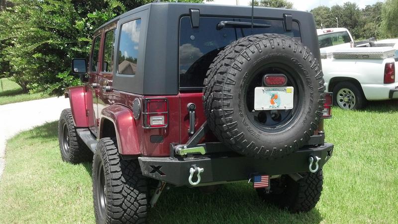

I rotate all 5. The only reason not to is if you have a donut spare... In which case, you are beyond hope.
I do the rearward cross. That is diagram "G" on this page:
http://www.tirerack.com/tires/tirete...141125014125:s
Jack right rear, swap for spare. Raise right front and swap for right rear. Raise left read and swap in front right. Raise left front put left rear on and left front goes to spare. Same amount of lifts (or less) as a 4-wheel rotation unless you let a shop do it. I don't trust shops to torque the lugs properly. In my experience typical shop torques anywhere from 60 to 120 ftlbs depending on air pressure and attitude of tech.
