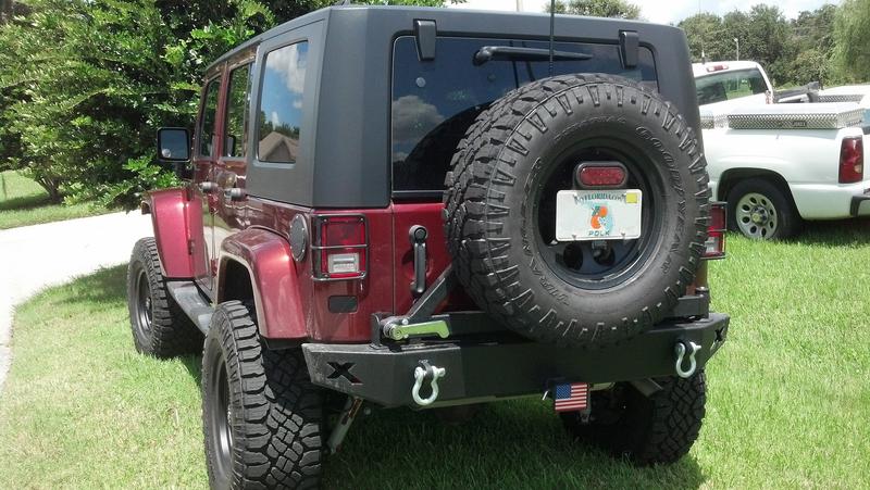

Taking the 4-tire rotation logic to it's most extreme...
If you want the least outlay per tire purchase, why not replace one tire every 10k miles? By the time you get to the 4th tire the first is ready to be replaced again!
Sure rotating 4 you will pay less to replace the 4 than 5 BUT rotating 4 will only give you 80% of the miles you would get rotating 5. That extra 20% miles saves you enough to pay for the 5th tire.
Besides, like JeepStin12 said, how many of us will want to re-shoe with the exact same make, model and size next time?

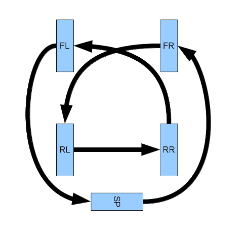

I have this taped inside my tool box, as well as a few other quick references. I like this rotation because all of the tires rotated face the opposite direction (opposite tread bite)
