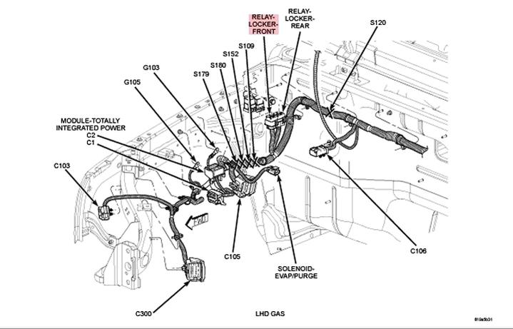

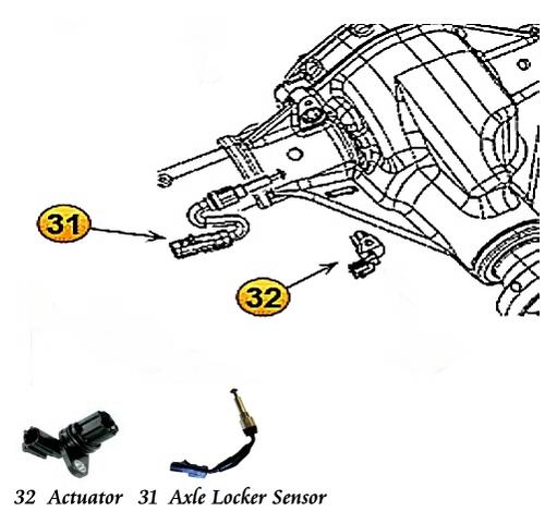

Originally Posted by livewire0212
Are the other wiring on the stock lockers for a rubicon for speed sensors??
Maybe this helps :-)

That helps a lot thank u!! Im not sure if I need anything going to the lock actuator??
