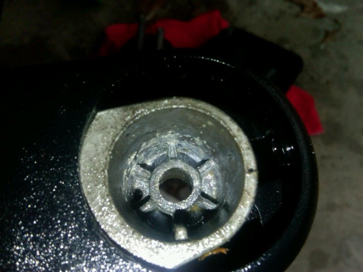

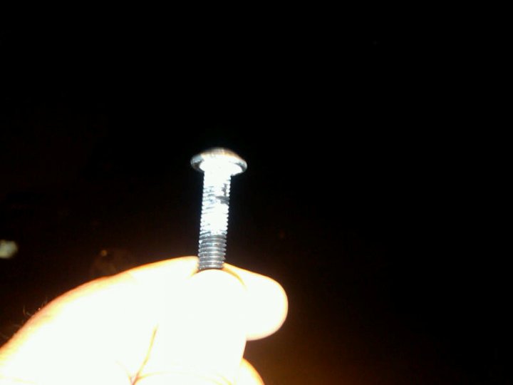

Here are some pics of the corrosion on the bolt from inside the mirror bracket and inside the factory bracket. They are made of aluminum and had all sorts of white corrosion junk gumming them up. [ATTACH]Click image for larger version

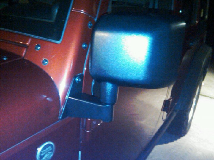

Finally a shot of the finished product. Click image for larger version
Regardless of the passenger side issue, I want to roll all summer long, as much as possible, doorless and then there will be no problem! I figure I can buy that secondary mirror everyone mentions...will try and see how that works out, but for now am excited to have done a mod all by myself and look forward to my first doorless day with mirrors!
Name:	corrosion on bolt.jpg
