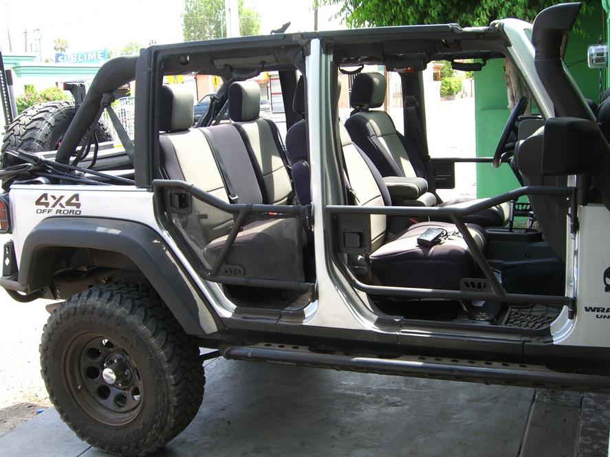

i have a snorkel so it hides them pretty good, but what i did was get some longer bolts, and a couple 3/4" CPVC couplings, painted them with the spray liner and put them between the relo bracket and the A pillar.
i am 6' 3" and my wife is 5' 3" and we can both see out the passenger side when the doors are off.
