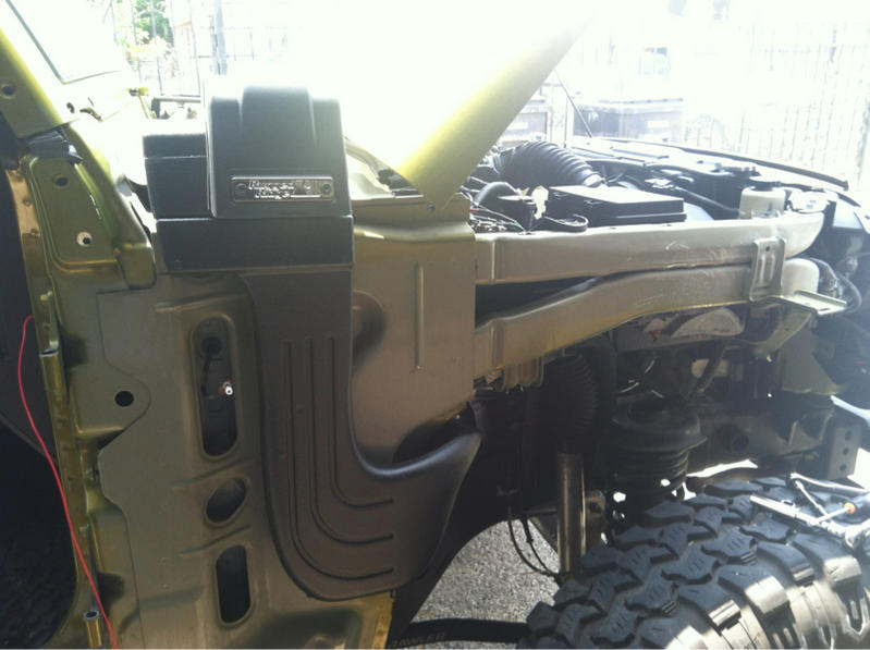

For those of you who have it.. does it stick out and block any of your view while driving? Also, do you think it will really be water proof? They have you using alot of sealant.[/QUOTE]
I installed mine, and love how it doesn't block my view, with the short mount you can't tell you have it while driving, also my thoughts exactly I wonder if it's water proof with all that sealant, only one way to find out!
