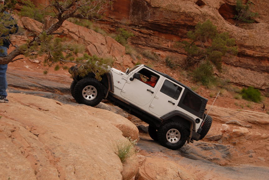

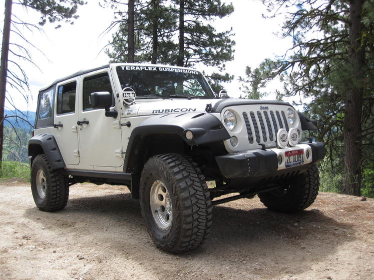

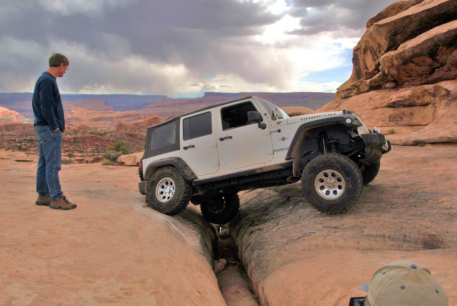

Here's a 3" Lift with the 9550 shocks and believe me I LOVE IT!!
I will say this you get what you pay for when it comes to shocks. If you spend $300 on each shock you will have a better ride than stock. but if you spend $60 on each shock you will not ride as nice as the stock ones. The Teraflex 9550 are a OK ride but I will be investing in something better down the road.
Make sure you buy the most Important part...The Teraflex Monster Track Bar! Believe me I've seen 4 other brands break! (One of them on another JK in our group broke right a this spot Golden Crack in the last 2 photos)
