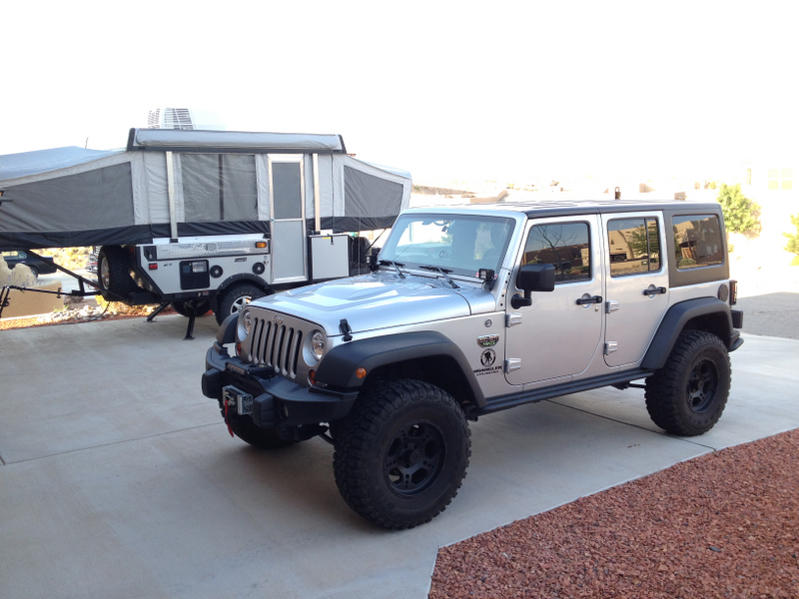

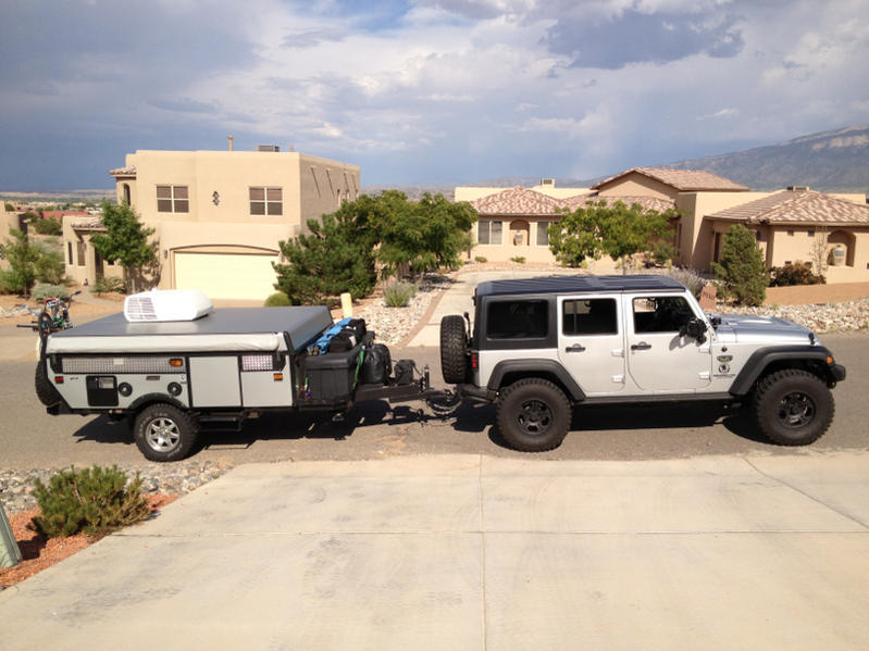

My setup:
AEV 2.5" w/ 35" Maxxis Bighorn on 17x9.
Auto 5spd w/ 3.73 on 3.6L Pentastar but plan to re-gear to 4.56 to keep my Daily Driver in the sweet spot and because I haul a camper and hit the trails once in a while. Lost a little pep w/ 35s but livable for now. Towing 3500lbs up Wolf Creek Pass CO is a tad ruff.
