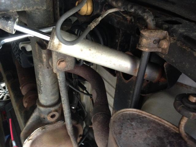

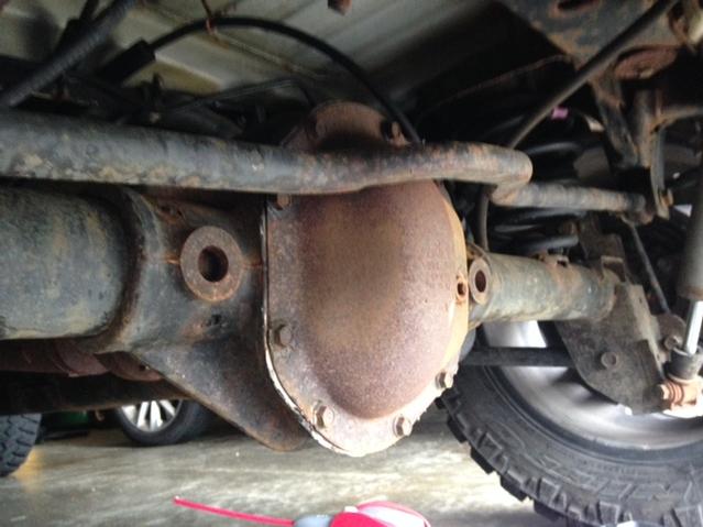

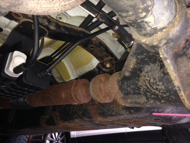

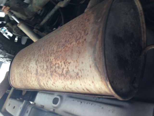

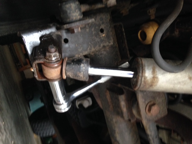

More pics (PRE-WORK). You can see what I am talking about better. I could not locate POR-15. Picked up some type of Loctite product. Anyone ever use or have experience with this stuff?

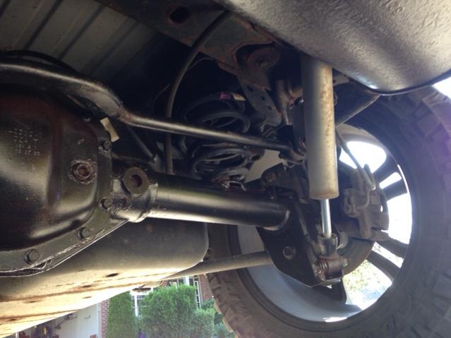

Also, if anyone wants to tell me what type of shocks these are in the back and what I should replace them with, I'm all ears.
Thanks!

just go over it every time it rusts up with more rattle can the frame semi gloss black , silver on the muffler mines a 12 & you just cant keep it from doin this unless you por 15 maybe . Toxic though i hear if you get it on you lol

Whoever is suggesting you just keep repainting rust with a rattle can has no idea what they are talking about! I did this years ago and watched my YJ undercarriage rust into oblivian! New rust will form under the paint and then the paint will flake off. You will get perhaps 3-6 months of paint coverage only to see the rust continue to eat everything and spread.
Decades later and now I know what to do: wire wheel or just hand sand off loose rust, then Metal Prep and apply POR15 on everything except the exhaust components which heat up. Also use Eastwood's internal frame coating on the inside of your frame rails. Then use VHT ceramic paint on the exhaust components that heat up. Then finish it all with Fluid Film.
It is worth your time to do this if you care about your vehicle and want to keep it long term. If you are looking for a quick 3-6 month visual fix for rust, then do the rattle can coverup method but believe me things will look like hell again and be significantly more eaten away a year later.

will need a new vehicle anyway . As for your muffler light brush and hit with silver spray paint works great . Some day after ten years you might have to spend $40 bucks and replace it . Its not like we dont see salt and rust here in nh Click image for larger version

These are all good suggestions and I very much appreciate you all taking the time to help. I do feel a little better that this is normal in a jeep. The POR-15 method seems to be the way to go. I plan to just bump the rust off with a wire wheel. Coat with some sort of rust KILLER, which today I have some sort of Loctite product (I cannot find POR-15 anywhere on the shelf). I wanted to start the process now and not wait for an online order to be delivered) and rattle can it. The Loctite stuff I have was $18 for a small bottle. The premise is the same as POR-15 but whatever it is applied to turns to a black paintable surface.
Question (or just for clarification) - since both products turn the surface to a black finish for painting, do you or do you not hit the exhaust? I saw painting it silver etc. but just wanted to clarify.

Here is a pic of what I started using: Click image for larger version
Look at the transformation after only 2 hours:

Appears to be turning black. Once this happens, is it really a matter of taking a can and going to town? Should I not care what the paint hits? I know.......dumb question but I have to ask it. New to Jeep and new to working on my own stuff!?!?!?!?! LOL!
