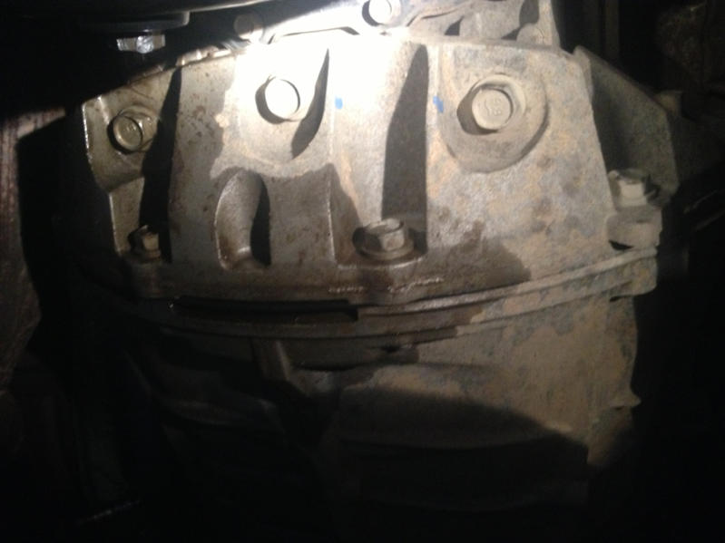

The inspection plate is on the bottom of the bell housing. Held on by four (IIRC) bolts. The slave cylinder can be seen and replaced without pulling the inspection plate. It is on the driver's side of the tranny, about half way up. Just follow the hydraulic line to it. It pokes to the rear from the bell housing and is held on by two bolts. The bleed valve is right next to it.
Is this the inspection plate?
