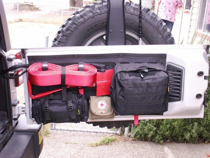

I screwed the top left corner then pulled it tight and then drilled the next screw in. I also stuck 3m heavy duty Velcro strips around the edges between each self tapping screws. I got a lot of weight on mine and I haven't had any issues with sagging. I also add a long strip of Velcro across the top so I can drape a black cloth over my gear to somewhat hide it when the top is off.
<img src="https://www.jk-forum.com/forums/attachment.php?attachmentid=244260"/>
Holy crap that is alot of weight. Thanks for the info
Attachment 244260

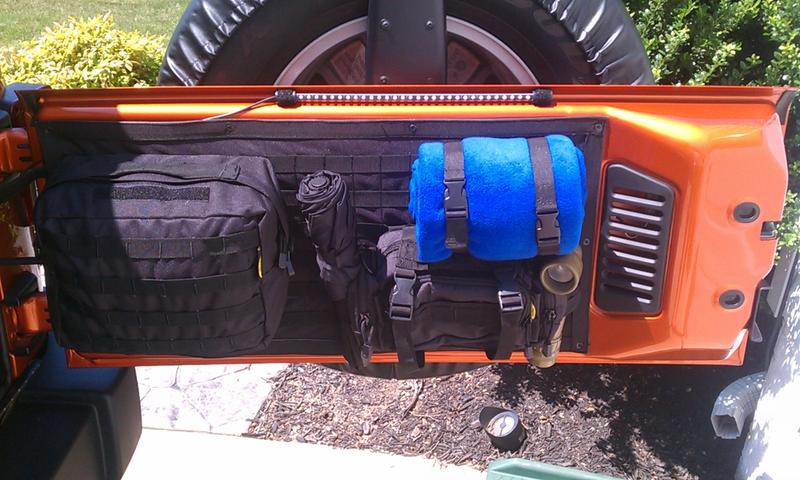

Wow, that picture speaks to how well you installed it. I started with top left and moved across also and it hasn't budged. However, I don't have near as much as you.
