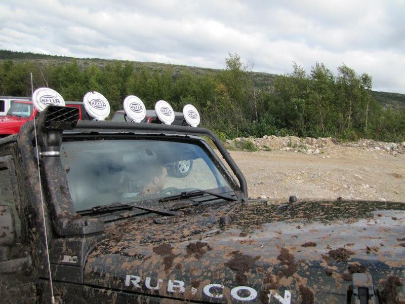

Hey Jersey Devil, did you get any water inside your cab?

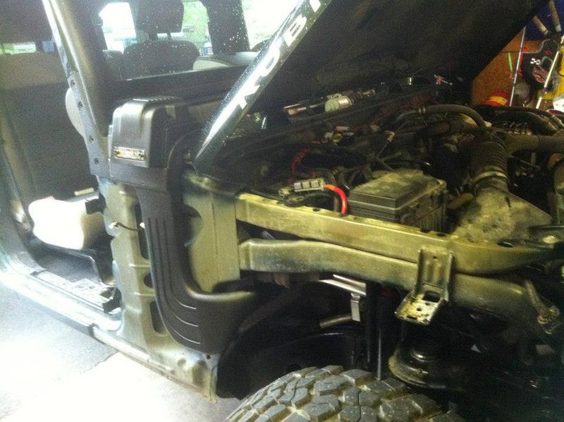

I have the Rugged ridge snorkel, and I bought it for two reasons. One, it fit with my Rugged Ridge light bar. Second, I liked the look of it. But, I have noticed a potential for a disaster in the design. The snorkel has three connections ( four if you include the drain hose on the bottom of the goose neck ). If these are not water tight, you can suck in water, especially from the drain hose hanging out of the bottom of the goose neck. Most of the snorkel path runs below the air box, not equivalent or higher like most other snorkels. This honestly makes me a little nervous. And no, I haven't tried her in deep water yet, I need to do the breather tubes.

Don't forget to seal the bottom of ur factory air box with silicone too.... There's some holes that needs to be sealed up. Yes I did get water in the cab...or did RR give u a new bottom section of the box? The whole time I was stuck u could look out and see the lil air bubbles from it seeping in my doors and slowly I started to hear the dripping.... All in all I had about 6" of water inside the cab

The bottom of the factory airbox is replaced by the one in the picture. And yes, I seals the holes in it.
