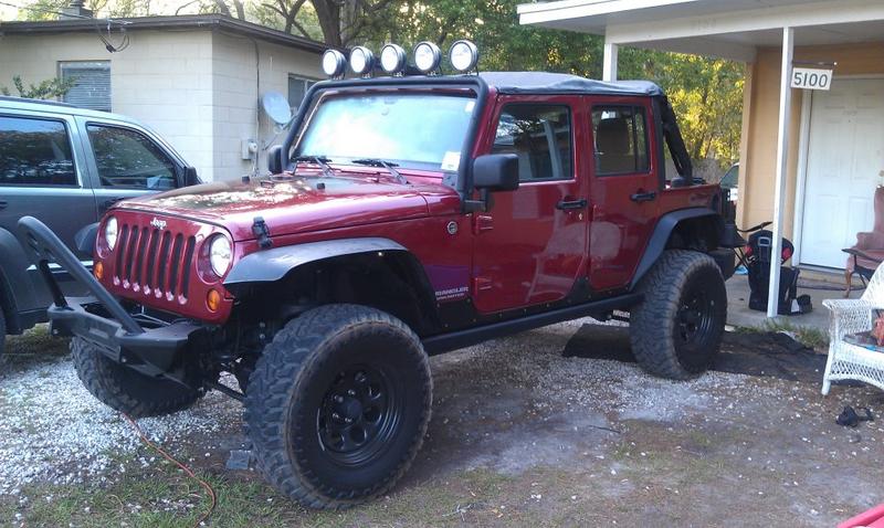

I had an extra soft top given to me, so I had the back cut off and turned into a bikini top. Cost me about $150 because I wanted it done to be able to last and look like it was made that way.

So now I have a Bikini, that doesn't leak, and I can still use the Sunrider function.

All you have to do is remove the brackets that mount to the roll bar in the rear and put the right bracket on the left bar and the left bracket on the right bar. This will allow you to fold the rear section all the way back to the upper roll bar. However by doing this it does lift the rear of the soft top about an inch, so it is a struggle to get the rear corners to clip into the tub. Its doable though. Once the top is foldable, you just need to tuck/fold the access however you please and then wrap the rear corners around the roll bars. I used the stretchy elastic that holds the rear window up to do this. I then used the Velcro straps that come with the sunrider to hold the 2 rear bars together. This keeps everything tight as well.
I plan on doing a mini write up to post in the write up section with more detailed pics.
