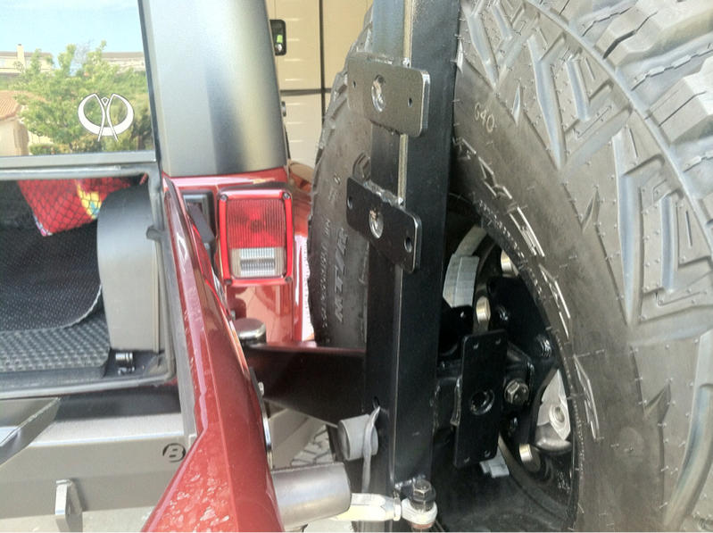

Originally Posted by Bootman83
BlackRock. Is there a gas can adapter that you know of for that High Rock set up?
Here's a pic of the working side of the High Rock carrier. On the bottom is the helm joint that keeps the swing arm and carrier together. The tailgate piece that the helm joint attaches to mounts with 4 bolts that held the stock drivers side tire carrier. So the stress is distributed to a large area. Then you see the swing arm, further up is right angle plate that's used for mounting a Hi-Lift. On top of that is a plate to hold a shovel. Then at the top of the vertical beam is a place for a CB antenna or flag. Inside of the wheel are plates to hold fire extinguishers. So using those mounting plates along with a fabbed rotopax mount, I'm sure you can design something that works.
And I just noticed the crapload of weights to balance 35 MTRk on 15" wheels.

Trail Duty: If you're still with us on this thread...you mind snapping a shot or two of your OR-Fab. I still love the OR-Fab my concern is compared to the rest does it support the weight well? Your thoughts TD?
BlackRock: Thanks again for the info. Man that looks good too. Your rig is sweet...
then again so are a lot of guys/girls on here so I appreciate the input and pics.
