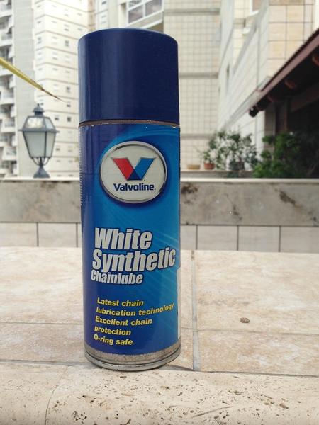

... WD-40...interesting. I might have to do some additional reading and use a different kind of oil or follow whatever procedure is agreed to be best practice. I was just thinking of something to use as a light coating because of all the crud that's going to get sprayed at the front of the Jeep on this upcoming trip.
This type of oil protects steel cables (Obviously, in liquid form they cost less than in spray cans) :
Or this type:
MOLYKOTE® L-0115FM GEAR OIL - ISO 150
'High-performance industrial lubricants for gearbox and chain applications'
Link -- MOLYKOTE® L-0115FM GEAR OIL - ISO 150
While I'm not saying leave your line dry, I caution you against using wet lubricants (to include grease) without routine inspections of your line. Wet lubricants will attract dirt and rocks that will get into the line and lead to kinks and breaks of not cleaned off.
