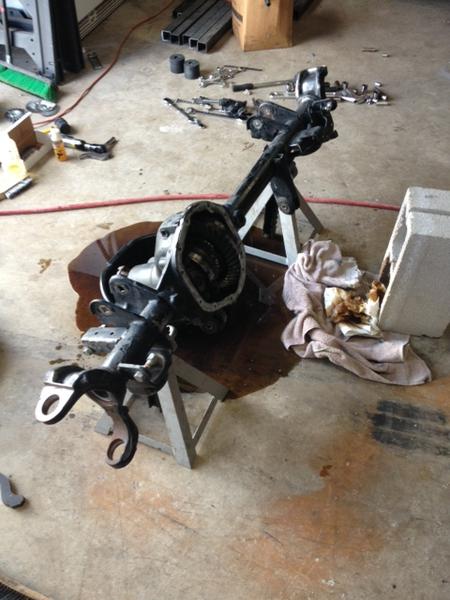

I started yesterday in my shop by putting the JK up on stands and getting the front axle torn down. I wanted to start with the sleeves since I needed to leave the axle on the Jeep in order to hammer the sleeves in. After they are in, I'll remove the axle completely to facilitate the other installs.

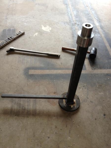

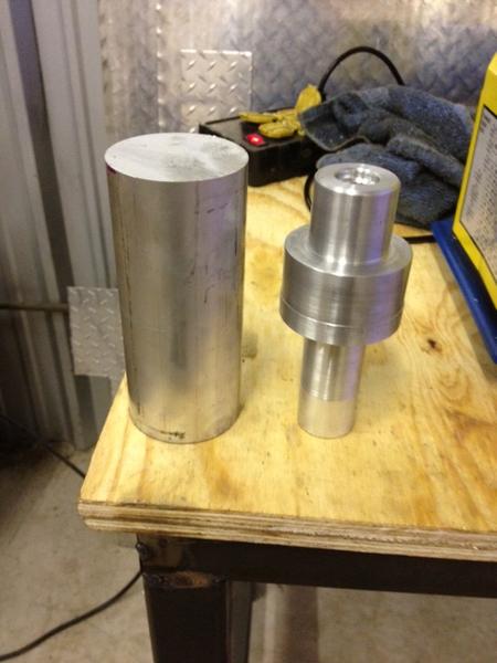

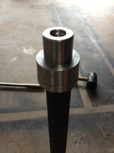

I went ahead and made my own Nitro sleeve driver from 6061 aluminum:
I started with a solid 6" plug and 3 hours of machining later, I had the perfect sleeve driver:
I took that and copied a tool I had seen on Youtube made of some simple square tube with a steel striker plate for the hammer:
ID:	478269Click image for larger version

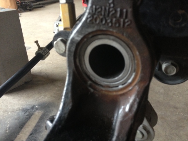

The sleeves sat in my shop's freezer for a week so with a buddies help and about 10 minutes they went in perfectly:

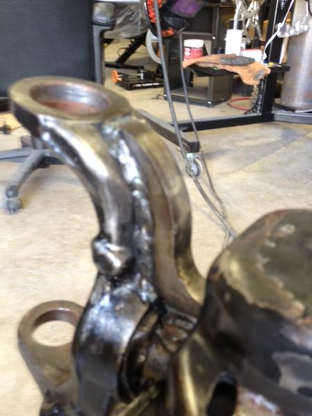

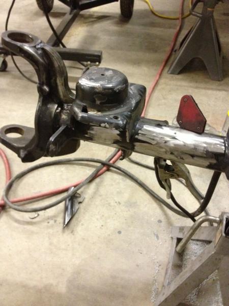

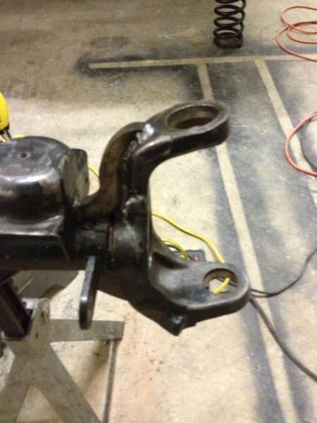

Update on the build. I got sidetracked for a couple of weeks with work;

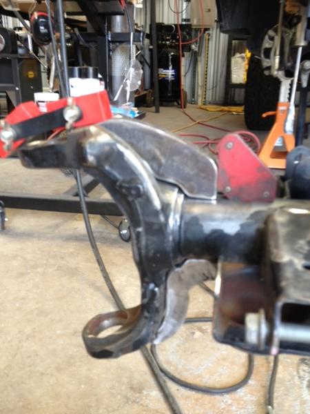

After I got the Nitro sleeves in, I removed the front axle (since I was going to adjust the caster anyways) and started to work on the Teraflex C-gussets:
ID:	492463Click image for larger version
Got everything welded in (taking my time):
ID:	492465Click image for larger version

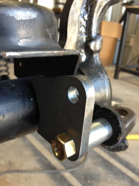

Then I removed the factory trackbar bracket (PoS) to replace it with the Synergy one:

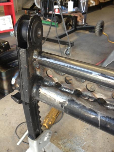

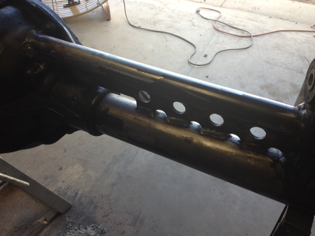

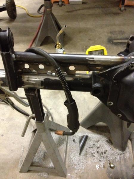

Then I started on the Rockrawler Axle Truss:
ID:	492469Click image for larger version
ID:	492470Click image for larger version
Finished putting in the Synergy trackbar bracket and the driver's side swaybar mount to work with the newly relocated one on the bracket:

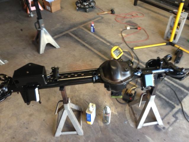

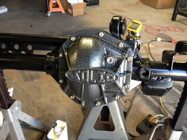

How it sits now; got my Solid cover installed:
Tonight I tackle the Synergy ball joints, putting it back in the vehicle, adjusting my arm, and reassembly of the knuckles, axles, etc..

Old Aug 27, 2013 | 03:21 PM
Gman*2007's Avatar
Posts: 2,552
From: Huntsville, TX
Nice weld job, can't wait to see the finish product

Old Aug 27, 2013 | 08:19 PM
5150cliff's Avatar
Posts: 326
From: Fontana, California
Nice machining job on that sleeve driver. Looks like it cost a bit though. I would have assumed that with the freezing of the sleeves, they should have pretty much slid in with little effort or at worst, with a block of wood and a medium hammer. How easy did they go in by the way?
