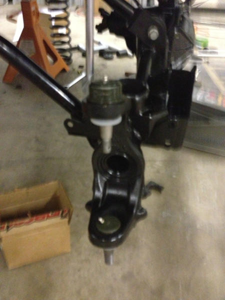

Another update. I got the ball joints in last night. Screwed up the little band that holds the Synergy ball joint boot to the stud, so I have to get another before I can put the knuckles back on:

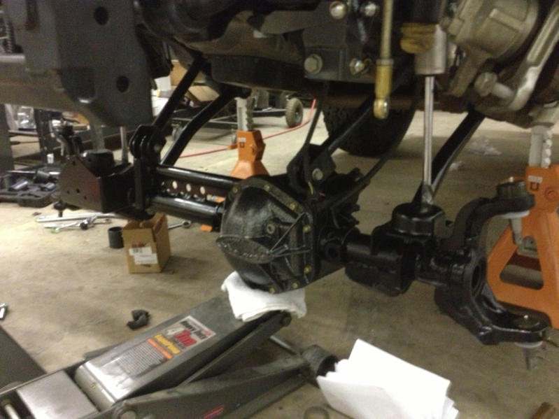

Here it is back in the Jeep with my arms adjusted for the correct caster.

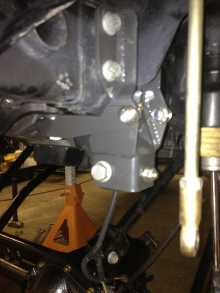

Then I went on to install my Synergy front track bar brace and sector shaft brace. Simple install. My pitman arm bolt was on with way less than the spec 180 ft/lbs of torque:
