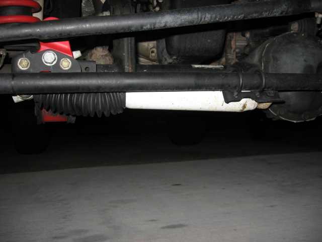

Originally Posted by derekls
OR pictures of your superlift steering stabilizer working with the FT tracks bars
Come on... no one?
Just went out to get a pic for you. its not great.
like that bracket, moves up and out of the way....how much was it? and were ya get it? my solution was easy enough but would like to get mine above tie rod..
the axle mount one is from Woods. you can get it off his site www.4xfix.com
username: jeep
password: forum
The tie rod bracket came with the superlift stabilizer.

Thanks for all those pictures, said a ton.
On mine, its hooked up with the super lift hardware the problem on mine occurs at the tie rod bracket bolt
Its making contact with the track bar, is yours?
EDIT: Maybe If I get the woods bracket it will allow me to move it away more from the tie rod?
