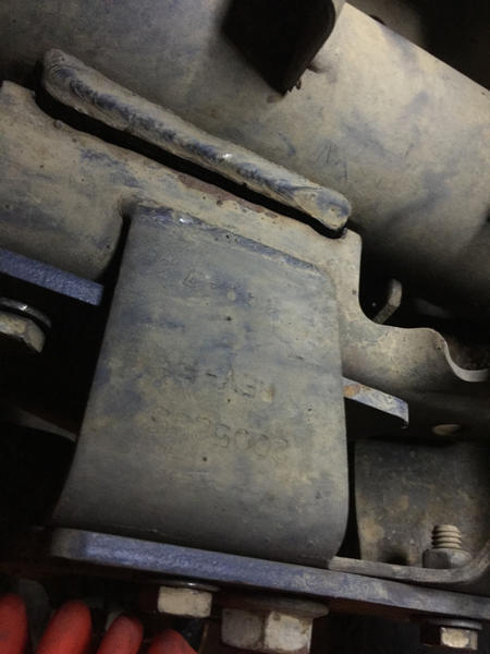

May have found my problem? This area is were the track bar connects too it snapped at the weld. Could this be causing everything?

Looks like my bottom weld and top weld is broken, the area on the right of the axle appears to want to break too the bracket area. This is what must be causing my issues. There are two dang screws or bolts that needed to go on the left of the braket during lift kit install. Looks like someone didn't do that and that's why these welds were stressed to breaking point?

This is your problem! I wouldn't travel too far until I got it fixed.... a good welder should be able to get it back in place! This happens even t ostock jk's at times! there are several reinforcement ideas out there to strengthen it... but a good welder can fix the weld, and maybe plate it heavier? This really would mess with your steering!
