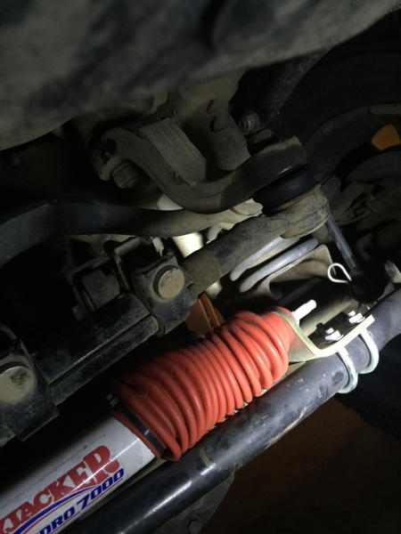

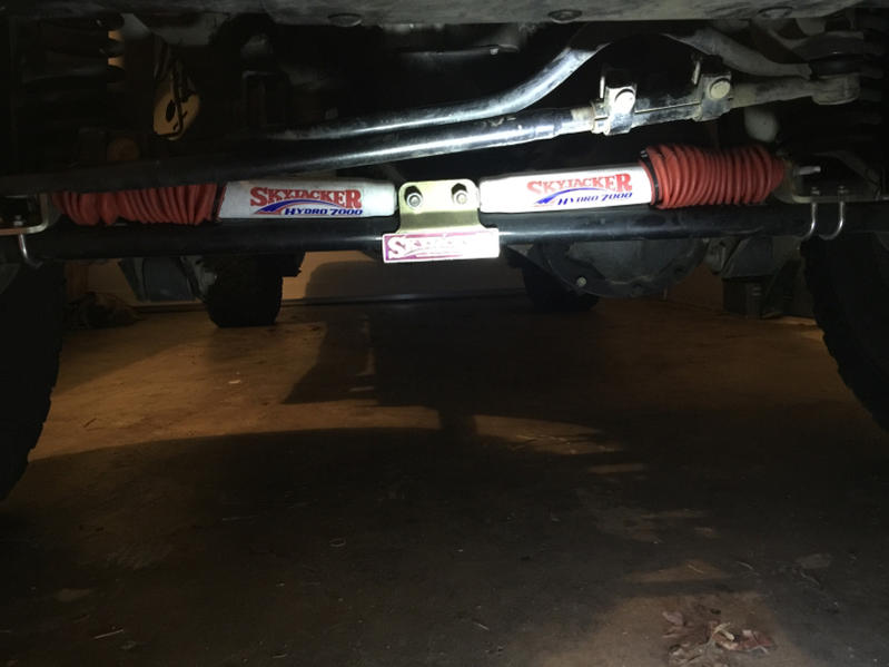

If you post a picture of the pitman arm we might be able to tell. Or even just a picture from the front of your jeep. You want your drag link and track bar to be as parallel as possible for good handling. Removing the bracket with a drop pitman arm would put them at two different angles.

Here's those photos guys, I called trail master which is who sold me the lift kit. They say I can remove that bracket and install an adjustable track bar and it won't mess things up?
Is this the kit?
Trail Master Part TM3335-40013 - 3.5 Inch Lift Kit with NGS Shocks - Fits 2007 to 2015 Wrangler, Rubicon and Unlimited - Trailmaster Suspension
As noted earlier, the trackbar and draglink should be relatively parallel to each other. When you added the drop pitman arm, you lowered one end of the draglink. The angles were off. So to fix it, a relocated trackbar bracket was also installed. Both bars were parallel before the lift, and due to the drop pitman & trackbar bracket, both bars remain parallel after the lift. Removing one without also removing the other is known to cause a nice case of bumpsteer.
Can't comment on who you spoke with at Trailmaster, but it might be worth your time to make another call...
It's a little hard for me to see but I think you'll be fine with using the stock location. Im that bracket doesn't seem to even lift it up very high. The left side of the picture is a tad dark to see. The only advantage to the adj track bar will be centering your axle. If you take the drop pitman arm off as well as the bracket they would probably be parallel.
