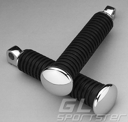

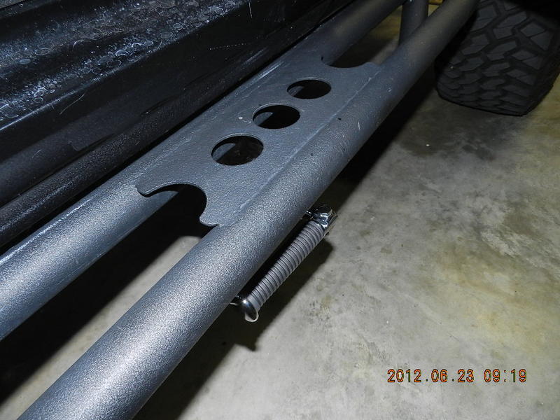

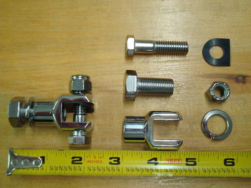

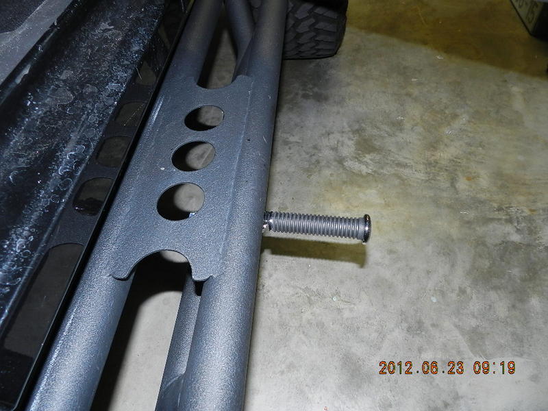

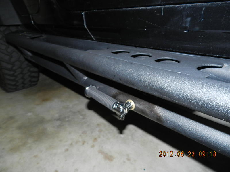

Here is my simple solution for under 50 bucks:
Harley footpegs Push them open to get in, then close them. If you forget and hit an object, they will fold in by themself.
