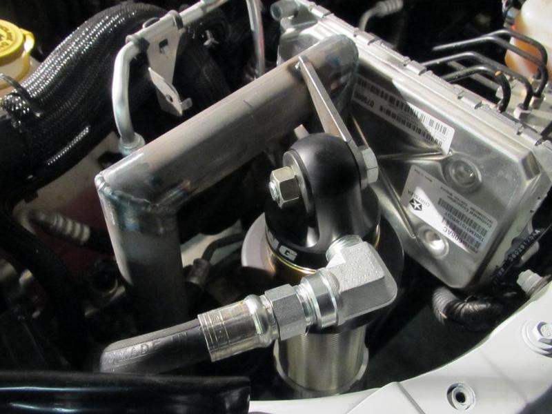

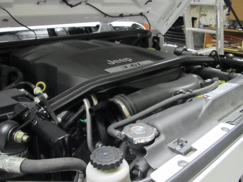

In response to wanting 14" CO's,, I agree with the previous post on going into the engine bay. On my build we had to ditch the washer reservoir on the drivers side and turn the computer sideways and mount it on the shock tower. On the passenger side we ditched the air filter box and shortened the intake tube to use a K&N unit. A brace bar was made to go over the engine cover between the towers. It is a very tight fit!! One problem with the shock tower on the passenger side is it gets in the way of any snorkel kit I might want to use,, so more custom work and more money is needed for a snorkel.
