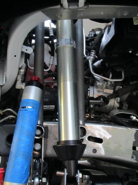

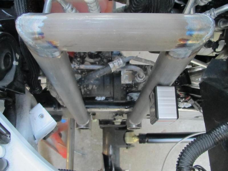

In response to wanting 14" CO's,, I agree with the previous post on going into the engine bay. On my build we had to ditch the washer reservoir on the drivers side and turn the computer sideways and mount it on the shock tower. On the passenger side we ditched the air filter box and shortened the intake tube to use a K&N unit. A brace bar was made to go over the engine cover between the towers. It is a very tight fit!! One problem with the shock tower on the passenger side is it gets in the way of any snorkel kit I might want to use,, so more custom work and more money is needed for a snorkel.

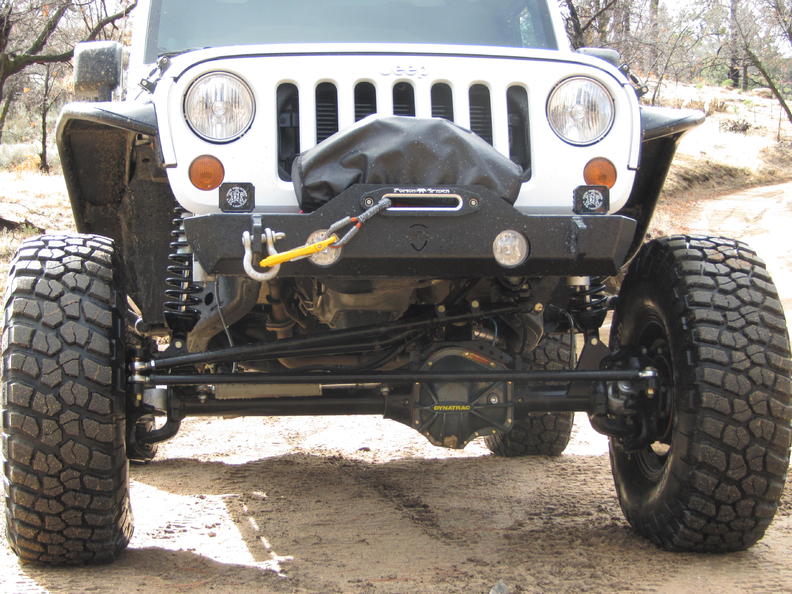

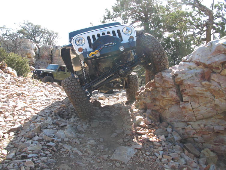

My shock tabs are on top of the tube. To be honest,, went with 14's because they are 2" more bad ass than 12's. As stated before,, 12's would have probably worked for my purpose. Sorry I dont have a bunch of numbers to post, I never really measured the lift. My guess is I'm sitting at about 5". I'm currently working with Rebel Off Road trying to dial in the shocks. They were WAY OFF from King. I have gone down 2 spring rates from the 300# lowers the shocks came with. As a result of the softer springs my front end is dropping a little, which is fine with me because it was too high before. Not totally dialed in yet,, but as it sits right now I have 4 1/2" of up travel. The towers are 19" high from the top of the frame rail.
This setup looks sweet. The crossover bar reminds me of a high horsepower racecar.
From a suspension design standpoint, do you want the shock at a 90 degree in front/back and left/right or is it better to have a slight angle in either of the directions? From one of your pictures it looks like there is a very slight angle from the top being a little more inboard than the bottom. Is this to help it fit or for performance gains?
Slightly angle out at the bottom helps a little with lateral stability. Slightly angled toward the center of the jeep at the top helps utilize more travel through the arc of the arms.
