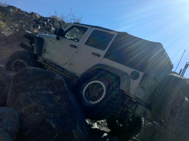

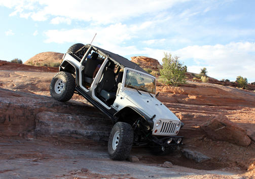

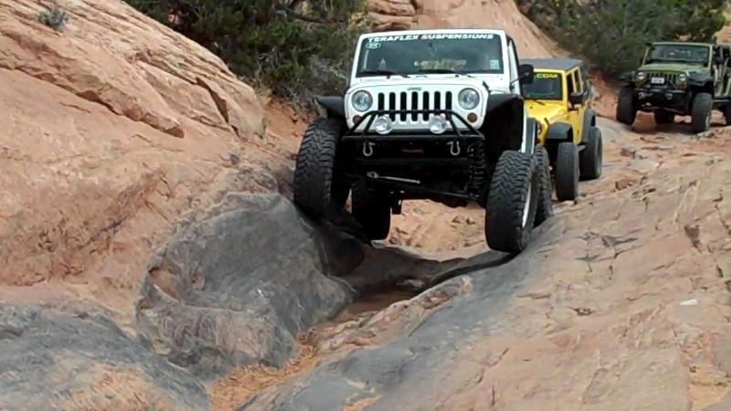

ID:	390384 i have to laugh to myself every time i try to answer one of these posts.the purpose of the ops question is to gather CORRECT info to determine what route he should take with his build.there is only one correct answer to his question and it is that it does not work.you may get by with it for a while but make no mistake,those tires begin to damage pretty much every part of your drivetrain as soon as you put them on.this is not speculation but a fact.wheeling is pretty much one of my main hobbies and i have built my own rigs and have wheeled some of the toughest stuff around,believe me when i say that i have seen this set up fail first hand even only driving it on the street.i also design build and test fly aircraft for a living and have gone through my jk in every aspect to cover any weak points.i have done my homework and then built mine myself from a 2wd platform.take what i say with a grain of salt if you like after all it is your money and rig but i am feeding you facts from experience.not trying to upset anyone here,just trying to make sure the info is all correct

ball joints,power steering pump,steering sector shaft,bent rear axle shaft flange,steering box,stock d30 u joint,these are the things i have personally seen go out on a friends jk on 37s used pretty much only on the street. this is the trend.also i am not trying to prove anything,another poster stated that a lot of guys on this forum get there info from this forum and pretty much don't know what they are talking about...i am not one of these guys.on my rig after i reenforced my steering i still ruined my power steering pump due to overheating.the fluid actually boiled right out.this was not on the street though but happened on just one trip running the dusy ershim.

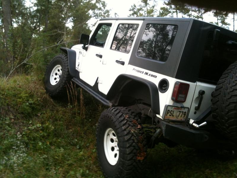

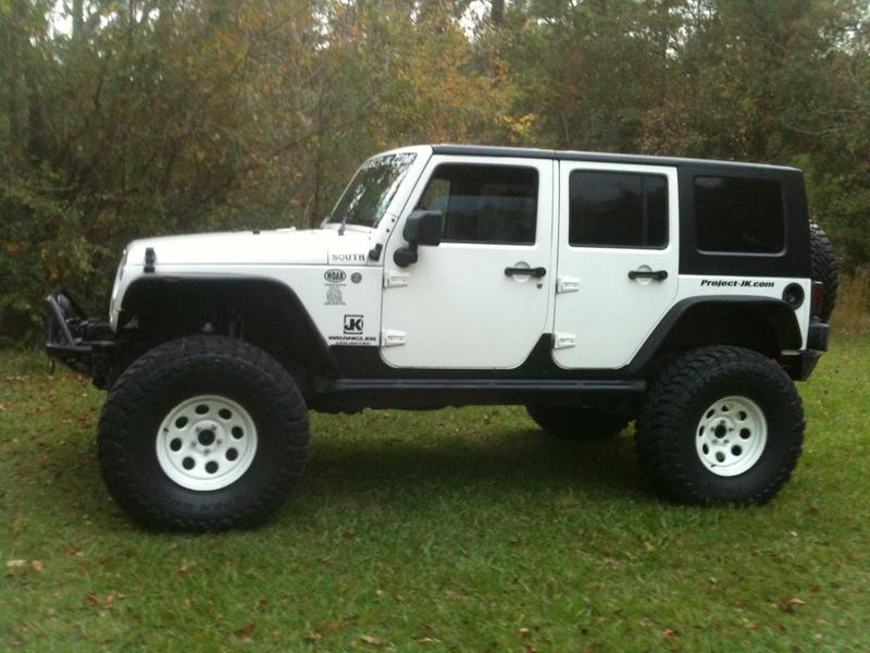

D-30, 37's
now on 40's
Name:	October 2012 027.jpg
Name:	October 2012 028.jpg
