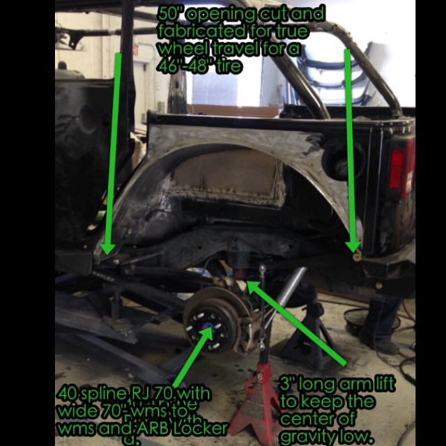

You could just go the BlackOps4x4 route. Major trimming.

To run 42x13.5" tires I would recommend a 72" WMS with a 3.5-4" BS to maintain full turn and have room for axle rotation during articulation. Of course your suspension design and amount of travel you have will be a factor. With a conventional coil set up at 4" of lift you are not going to have much up travel without major cutting of the tub, but being a crawler that may not be an issue for you. I would really recommend you look at a double triangulated long arm with coil overs if you are looking to climb about anything.
