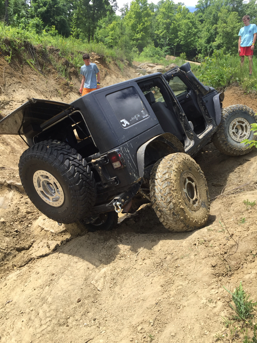

When I made the jump to 40" I got new control arms and it pushed the dead end back about 2" which really helped. Also did apt of trimming

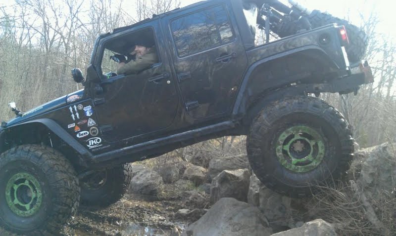

It's not all that hard been running that setup for 3 years I did stretch my rear about 3" to put the wheel in the center of the wheel well your mostly looking at getting rid of the pinch seam that what gets in the way when your at full stuff.
.Click image for larger version

Are you local? That pic of your jeep on the trail looks like Upper Ditch at Hawk Pride Mountain.
