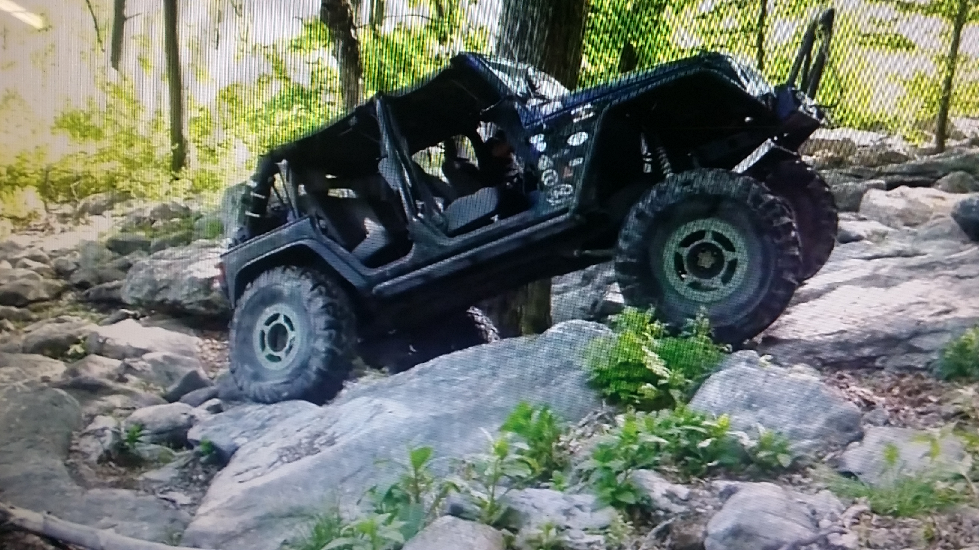

Are you local? That pic of your jeep on the trail looks like Upper Ditch at Hawk Pride Mountain.
lol you have a good eye that is exactly where that is. I'm from Memphis and that was from the upper ditch about 3 weeks ago

Badass rig. What was your axle setup and lift height when you were running the 41s? Got any pics of it back then?
I was running a prorock 44 in the front and in the rear dana 44 with superior axle shafts. Lift was right around 5.5"-6".Click image for larger version
How well did that setup hold up at that level of your build? Looks like you wheeled it well. I had noticed where you could buy a pro rock 44 housing and transfer the rubi guts over to it. Were you able to turn lock to lock flexed out without getting into the frame or did you notch it? Those pics are with a 3" rear stretch like you posted earlier or less? Any stretch in front?
It held up very well my prorock had rcv shafts in it never any issues the rear 44 was the weak link shafts couldn't handle the bigger tires I did notch the the frame so I had no problems turning lock to lock and yes it was with the 3" stretch in the back.
