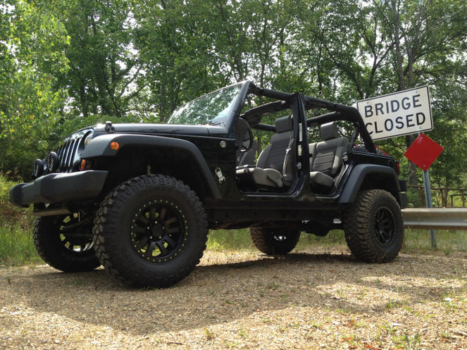

4.5" BDS system and 35's with no highway issues.
Sorry to hear of your troubles, it can be so frustrating sometimes.
Front steering stabilizer might be worn??
