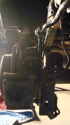

Help! I've had quite the day trying to install the Teraflex 2.5" BB Installation on my '08 X Unlimited. Its still not together and I even broke the studs on top of both the front shocks! Below are my real issues. I attached pics of how I currently have it set up (which I think is correct).
I've been reading the project-jk write-up (http://project-jk.com/jeep-jk-write-...ation-write-up) and following the included Teraflex instructions (http://www.teraflex.biz/category/tec...-instructions/) but they are slightly different in photos for the rear sway bar link (step 41.).
1. The Teraflex instructions show the rear sway bar link on the inboard side (closer to the shock) of the mount. The project-jk write-up shows it on the outboard side. It seems that the new sway bar link ends are larger in diameter and would prevent me from installing them on the inboard side. Plus wouldn't they hit the shocks? Which is the correct placement?
2. The rear brake line extension brackets. The bend is supposed to be installed on the inboard side correct? The passenger side does makes the brake line bind a little bit. I'm not sure I'm comfortable trying to bend the brake lines. Any suggestions here?
3. If I need to make steering adjustments (step 55.) do I do this with the jeep on the ground or does it need to be on jack stands somewhere?
4. One more! Can the front sway bar links be reconnected with the jeep on the ground?
Mine worked with the install on the inside as suggested by the directions with no problems to date. Also, check this thread too https://www.jk-forum.com/forums/showthread.php?t=30392 I had also sent a few PM's to JulietKilo for advise as well as Joe Thompson (Teraflex rep on the site here)
This is a trial and error thing... Adjust and test, adjust and test, adjust some more and test... Eventually you will get it set, and can be completed on the ground
That is how i did mine
One other thing I will note... I had an issue when installing my stock wheels with the location of the bolt at the top of the rear sway bar. It rubbed on one side... Quick flop of the bolt and was good to go until my wheels and tires arrived.
1. I have mine on the inside per instructions. THey fit fine and contact nothing.
2. Yes, the brackets are suppose to install so that the lines are sorta "under" the frame rail, so to speak. This is to make sure that they do not contact anything beyond the frame rail on the outside. Yes, there's no problem tweaking the line enough to fit. It won't hurt a thing.
3. The best case scenario would be on an alignment rack on some slip plates so the tires can turn without resistance. If you have a concrete slab, you can grease up the floor where the tires will contact and that will work great.
4. Certainly. Since most people disconnect them on the ground for wheeling, they can by all means be installed on the ground.
