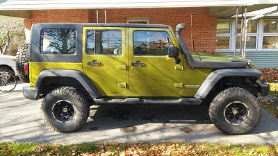

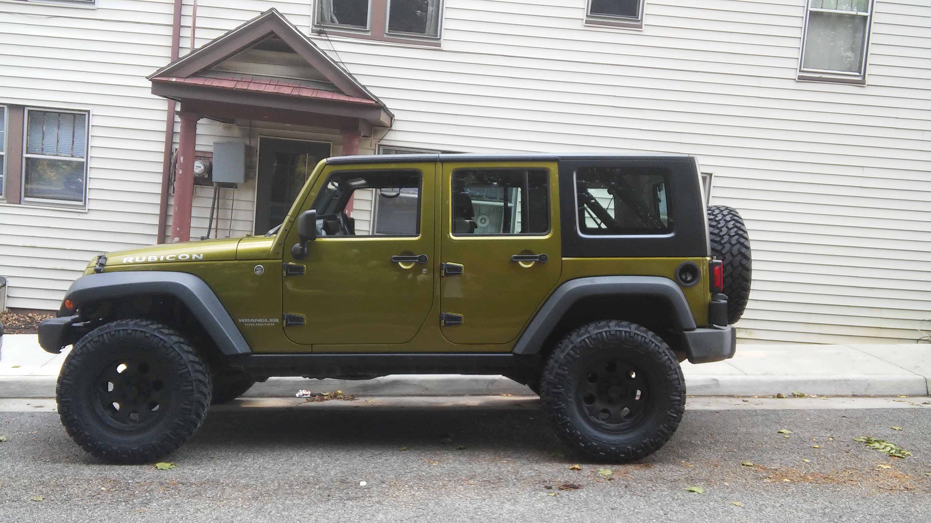

Very happy with my 2.5" MC Dual Rate kit on my 4dr. It netted me about 3.25" of lift, but I'm running pretty light. I ran it with 33s for a while and it performed great, now running with my 35s I couldn't be happier. What ultimately swung my decision was that it came with UCAs for castor, the front track bar and rear bracket, brake lines, and some other odds and ends that I knew I would need sooner rather then later.
33s

33s stacked onto my buddies 35s

35s

35s, chopped flares
