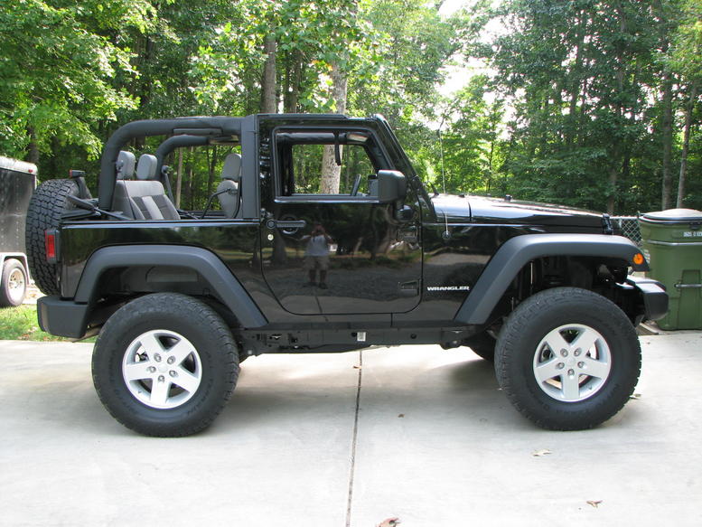

I believe I got more than 2.5" out of the Teraflex coils, AZ-JKs front fender measured 24" and mine measure 25.5" in the same spot. Maybe because its a 2 door? Anyone know?
Wow...looks greats Jst four K-X. Keep the pics coming.
You bastage! Kidding. That is really interesting. Especially considering I have an extra 3/4" spacer and reduced weight up front. Hmm? Maybe one of us got a wrong part? Maybe you got longer coils? I imagine the weight of the 4 door to the 2 door would impact it, but 1.5"???? That doesnt seem right. If it was .5-1" I would buy it. Hmm.
Calling JOE at Tereaflex?????? Any thoughts??????

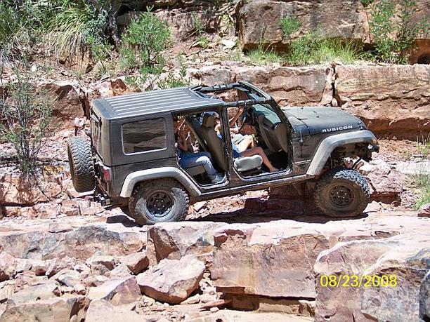

No, no word. I just PM'ed Joe and put in a link to this thread so hopefully he can respond. I havent gone back to re-measure, but I know mine has settled more. I'm pretty worried about squeezing 35's under it now. Here is a pic that is not full stuff in the rear, but is up pretty good and off camber... Not much room in the rear there...

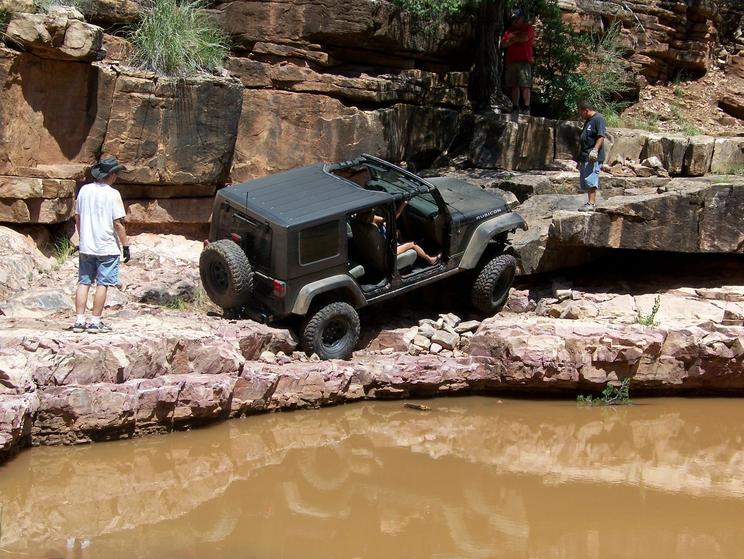

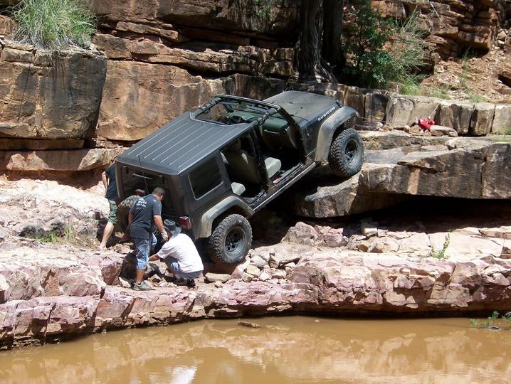

This is a pic of why I need at LEAST 35" tires... Also a great example of why front and rear bumpers can really disable you of they inhibit your approach angle. I think this would need 37's to get over, but you never know when you get lucky and also have the perfect line. I saw lots of WELL built rigs NOT make this fall...
