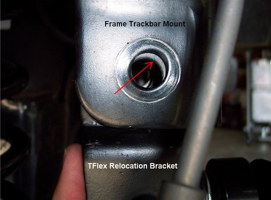

I think if you buy the adjustable rear track bar, you don't have to use the bracket. You only have to drill one spot, and thats the one in the first picture, it's more or less just to give the bracket more stability and I don't think it would affect the stability of the stock frame area, if you were to ever get rid of it.

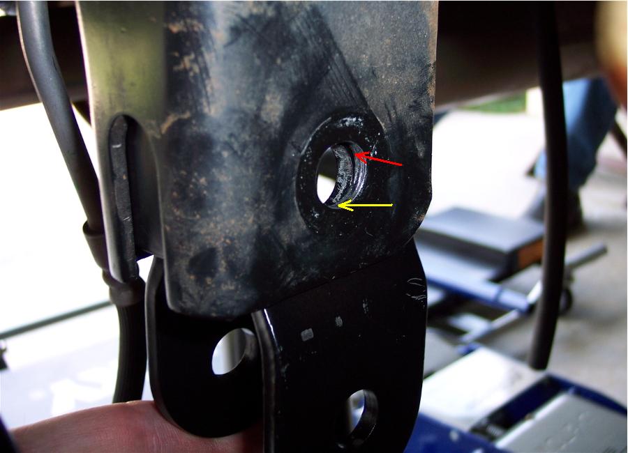

If it had been possible to lay my hands on a rear adjustable track bar at the time I was installing that bracket, I would have paid double for it, and smashed that low quality bracket with a sledge hammer. Do yourself a favor and buy the adjustable track bars.
First pic shows misalignment on bracket side closest to front of vehicle. Red arrow pointing to offset in upper right, while yellow shows factory hole above the TF hole.

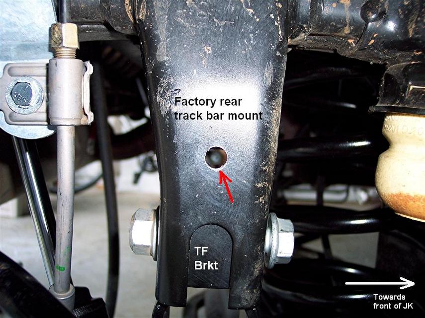

This is misalignment on side facing toward rear of vehicle. You can see the misalignments weren't the same front and rear (rear facing hole is worse).

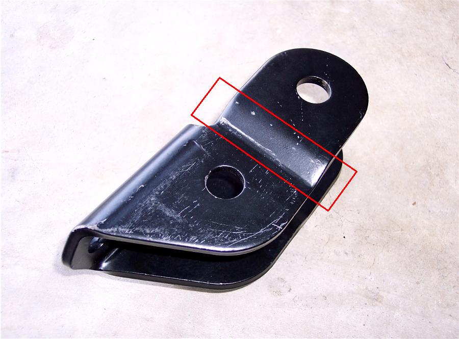

Problem seemed to be twofold: First the TF bracket wouldn't insert completely into the factory track bar bracket (thus the comments by some re the big hammer), and secondly, even if I had pounded it up into the factory bracket, the holes still wouldn't have aligned properly. You can see interference marks in the bend on the TF bracket.

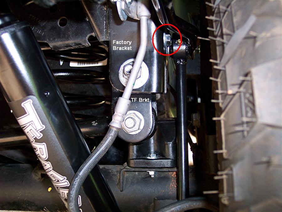

Had to put the TF bracket in a vice, and do a little filing in order to make it align properly (I guess that was okay, seems fairly sturdy at the moment). Once we could align the brackets, we measured for the hole in the factory bracket, removed the TF brkt, drilled, then reinstalled the TF brkt. Amazingly the alignment turned out perfect!!

Last pic is of the final assembled product. New bolt going through the hole drilled in the factory bracket is circled in red.
