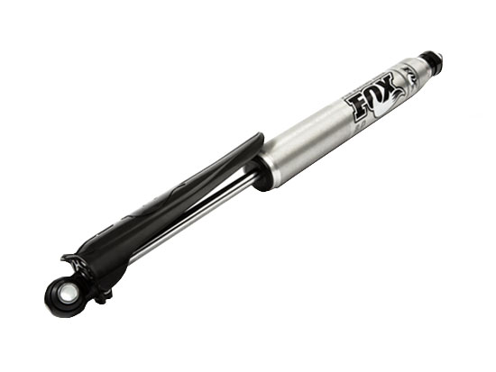

Big fan of Teraflex products. Those front shocks looks fantastic, but that rear design is the same poor design of Rancho's shocks. Meaning, keeping the shock body down and exposed is a huge no-no in my book. I crunched a 9000xl fairly quickly-- that cheap plastic knob, and then on another trip, the shock body itself. That location is simply too vulnerable. I'm especially interested to see how many people running the reservoirs back there suffer the same fate.
I'd like to hear a justification why it was designed that way.
edit-- I watched the video response posted below. Very impressive. I was so annoyed at the poor design of Rancho that I assumed TF would suffer the same fate. I admit I'm likely wrong. The fact that they strengthened the lower portion of the shock is very impressive. I'm not 100% convinced that it's the best design, but I do like that this specific issue is addressed. A Rooster tail guard, or even a plastic sleeve could rectify the danger of rock chips on the shaft.Click image for larger version
I know what you're saying, after the Rubicon my rear-lower shocks mounts took a lot of abuse!
The biggest reason for the rear shock bodies being down is to keep the shock shaft from getting beat-up by rocks, dirt, road-grime & debris that would get kicked up from the front tires. A beat up shock shaft ends up tearing up the shock seal & they start leaking pretty quickly. TeraFlex has built these Falcons to take a beating, they know what we're going to do to them... the aluminum body is built with "Type 3 Hard Anodized" which is incredibly hard for superior protection. Plus, the lower mount is built to pivot around, so the shock has some give and it will deflect out of the way it if it gets hung up. The thickness of the body cap and the body is also extremely overkill to take a beating and keep on going. These aren't cheap, stamped steel shock bodies like Rancho's.
Also, moving the shock inward towards the wheel/tire offers even more protection. With these 2.1 mono-shocks, the bottom of the shock body is very well protected by the shock mount... you could possibly back up and run the shock into a rock, but you would have to try VERY hard and at that point, the beefy build quality comes into play. For the 3.3 Adjustable Piggyback Shock with the reservoir built on the bottom, I understand they are working on a bolt on skid plate that contours the body cap and extends to provide extra protection for the adjusters and will help further protect your investment.
