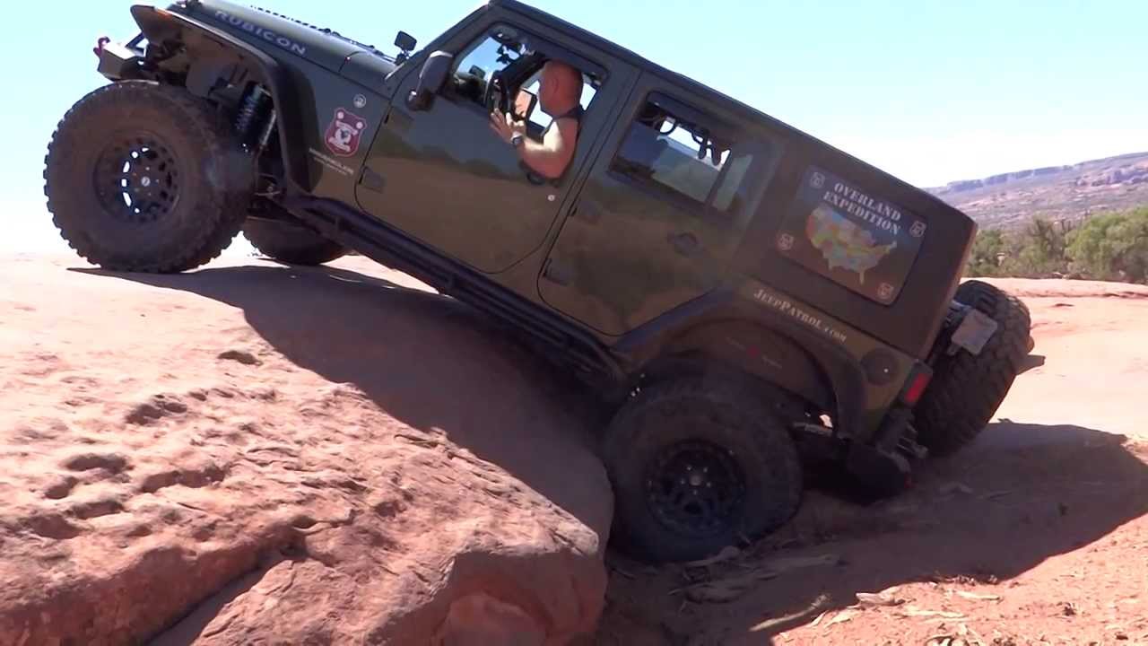

Originally Posted by Rancho
Most people spin that shock around in the rear to protect that knob.
If you are crunching the shock body, move the shock up, there are a lot of option (like the Rockstars) that get the shock body up and out of the way.
So, to rectify poor design, I spend time and money to install a custom mounting option to protect entry level shocks?
I went to Fox, haven't had an issue since. (In full disclosure, I've knicked the reservoir body enough to shove it upward, but it didn't cave in like my 9000xl) Rancho's are fine for what they are, and I'm glad they are a popular product. But anything past a mild fire road, those things are going to suffer. There is simply no reason to put a shock body in harm's way rather than using a sleeve or similar shaft protector. Funny thing about rocks, is that they never lose in a fistfight with components.
Like a previous poster stated, the less of my Jeep that can smash into the rocks, the better. Look at this picture. If those are your shocks down low like that, what makes more sense? Less shock to smash, or more?

Here were are on a fire road out in Sand Hollow, no damage to the knob or the shock.
Weird....
See below in bold
Originally Posted by bonanza
Attachment 666148
So, to rectify poor design, I spend time and money to install a custom mounting option to protect entry level shocks? Wait a minute we didn't design the lower shock mount the last time I checked
I went to Fox, haven't had an issue since. (In full disclosure, I've knicked the reservoir body enough to shove it upward, but it didn't cave in like my 9000xl) Rancho's are fine for what they are, and I'm glad they are a popular product. But anything past a mild fire road, those things are going to suffer. There is simply no reason to put a shock body in harm's way rather than using a sleeve or similar shaft protector. Funny thing about rocks, is that they never lose in a fistfight with components. Hence why many spin the shock body to protect the knob
Like a previous poster stated, the less of my Jeep that can smash into the rocks, the better. Look at this picture. If those are your shocks down low like that, what makes more sense? Less shock to smash, or more? So to the point, spend the few bucks and get that shock up and out of the way.
