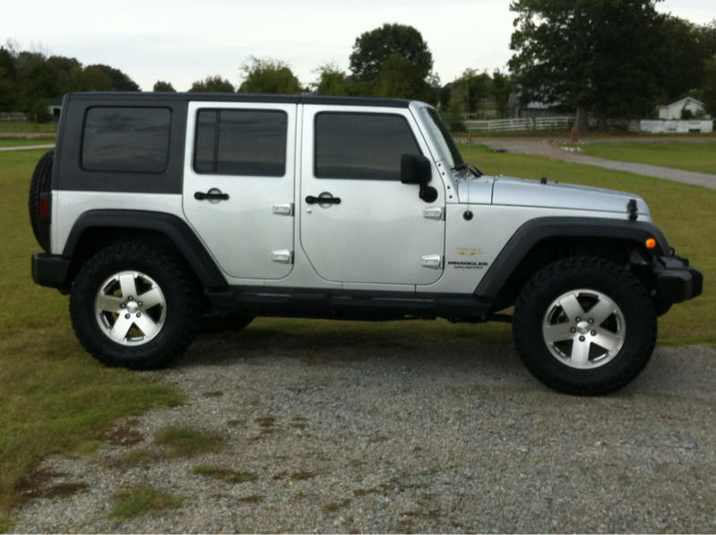

I installed that lift today. I had to use coil spring compressors both front and back to get the coils back in.. When I lowered to rear axle I had to disconnect the emergency brake from the tub to have enough slack to get the spring out. Other than that went smooth. I installed 295/70/18 Trail Grapplers and wheel spacers.
This isn't in level ground but I have plenty of room.
