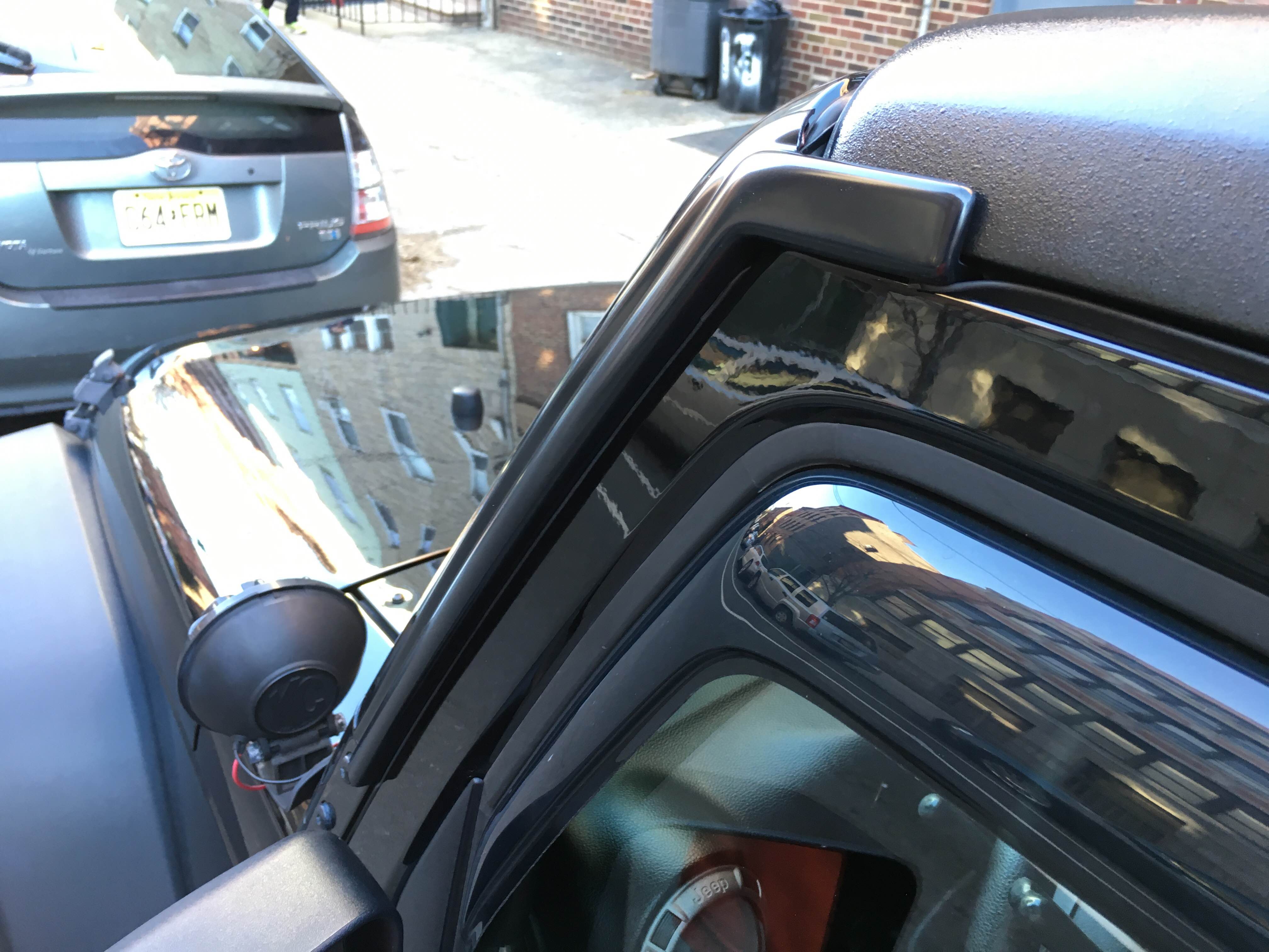

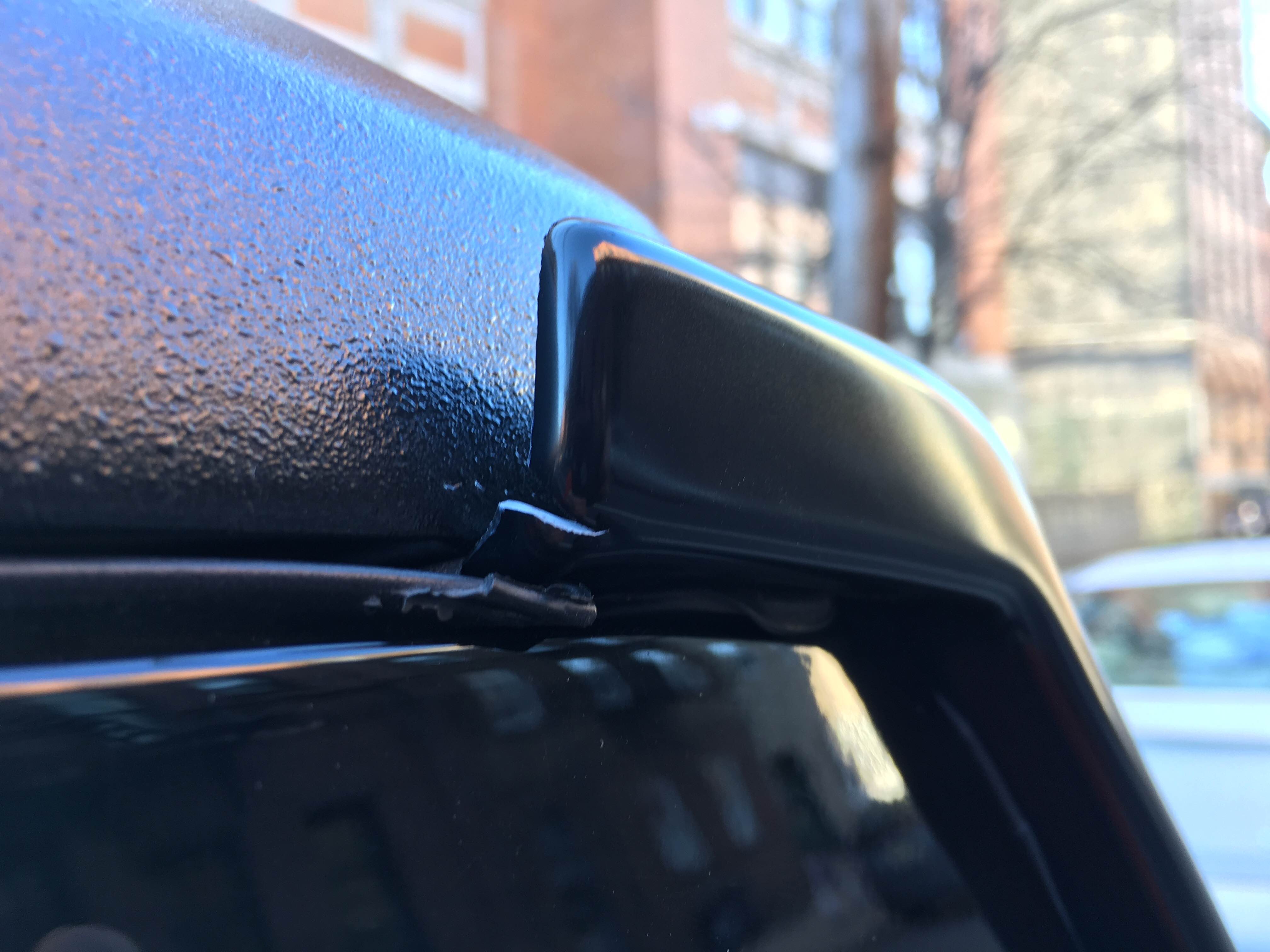

Tried installing the drip rails today.
They were a tight fit... too tight. The door wouldn't really close, and I ended up cracking one. Also, they had a pretty awkward fit. The curve of the drip rail didn't exactly match that of the jeep, so the sticky tape didn't make good contact. So, even if I didn't crack that one, I probably wouldn't have left them on there. It seemed like they wouldn't have lasted very long.
Slightly disappointed, but can't say I didn't expect something like this to happen. Now I'm looking into adjusting my doors and coming up with a DIY solution to the drip.

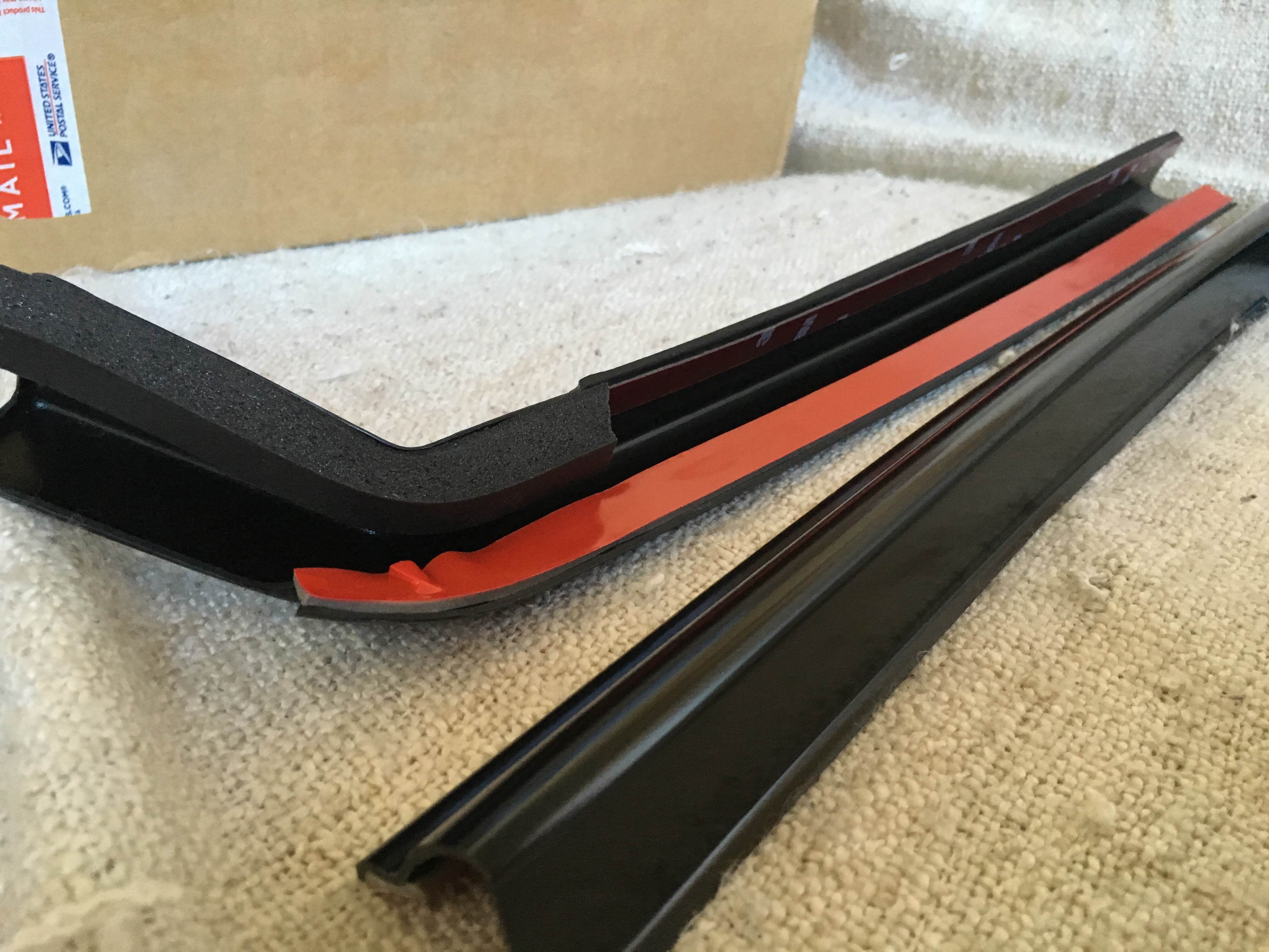

So i took the plunge and ordered a set. They look well designed although the spongy seal on top is separated from both rails.

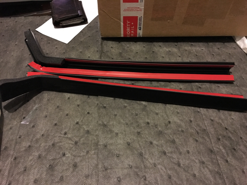

Ok i put on one side to see how things go.
Bill said to me these are NOT meant to stop leaking. But the way i see it --with mine at least--the water channels to the door and then inside the jeep through the top corner. Will see what happens.
I did have to reset it which i did not want to do.
If you dont push up on the top before the sides. When the door is closed it pushed on the rail and creases the seal. By doing it this way the door closes fine.
Tomorrow we are supposed to get some rain .. Will update then.
