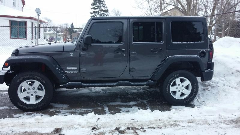

Default just installed Rancho 9000 series shocks and a Daystar 1.75" spring spacer lift
Love the ride. Definitely notice a difference compared to the stock sport shocks. The Daystar lift, though modest, gives a more aggressive look. Happy with the outcome as far as the look and quality of the ride.Click image for larger version
