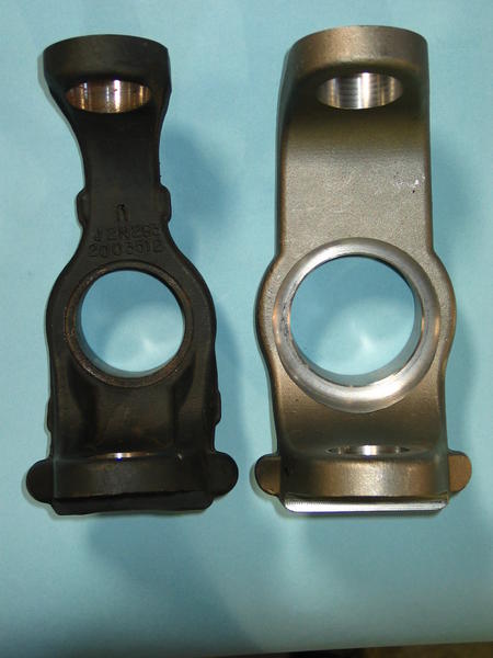

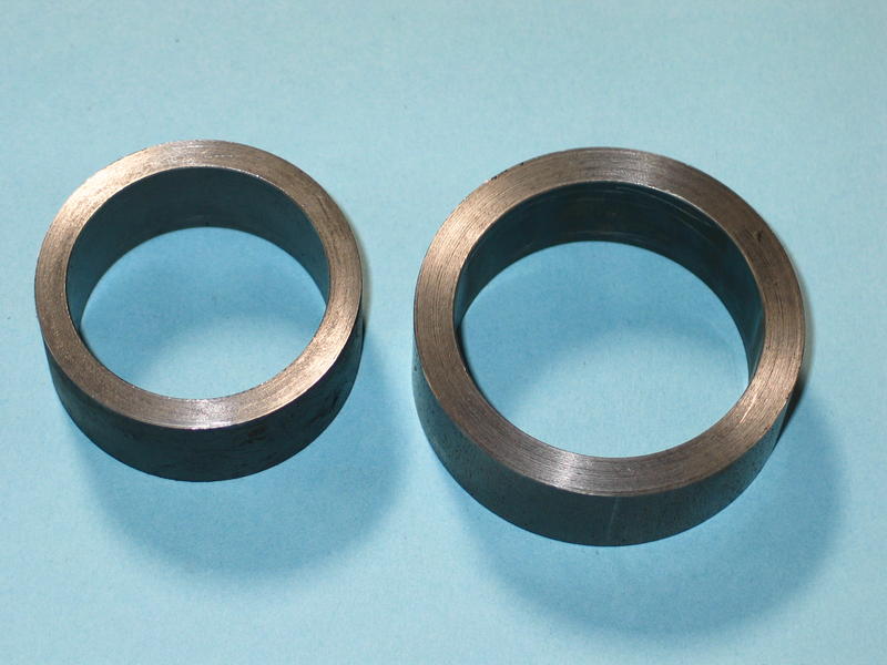

This is how we've handled bent 'C's and tubes. If you plan on using your Jeep and want to avoid further issues, the ProRock 44 is the answer. It's not cheap, but over the long haul it's a great investment.

I see the differnece, I just cant be putting that much cash into the rig at the moment (for NEW parts). If I can find a PR44 or a Rubi D44 for a good deal then im all over it. For the time being ill just have to replace the ball joints and hope the other side doesnt go.

Save the money and go with the PR44, thats what I am currently saving for. Bent my D30, you'll be able to drive on it for a little while without probably too many issues. Been driving on mine for a while now and its holding up (knock on wood). The sooner you can replace it the better. If you wanna cheap out I know theres a guy on the forum out in PHX selling a stock D30.
