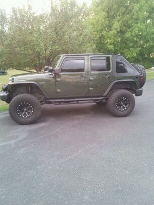

I have a 4" and need 37's. Well after the long list of upgrades needed to run them!?
ID:	376343 Click image for larger version
