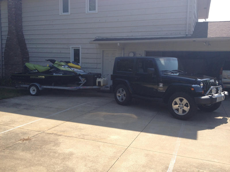

Just keep it under control, not too fast. I tow 2000 lbs with my '08 2DR and it handles it well. I added an auto trans cooler but having a 2012, I believe you already have one if you went with the auto.
