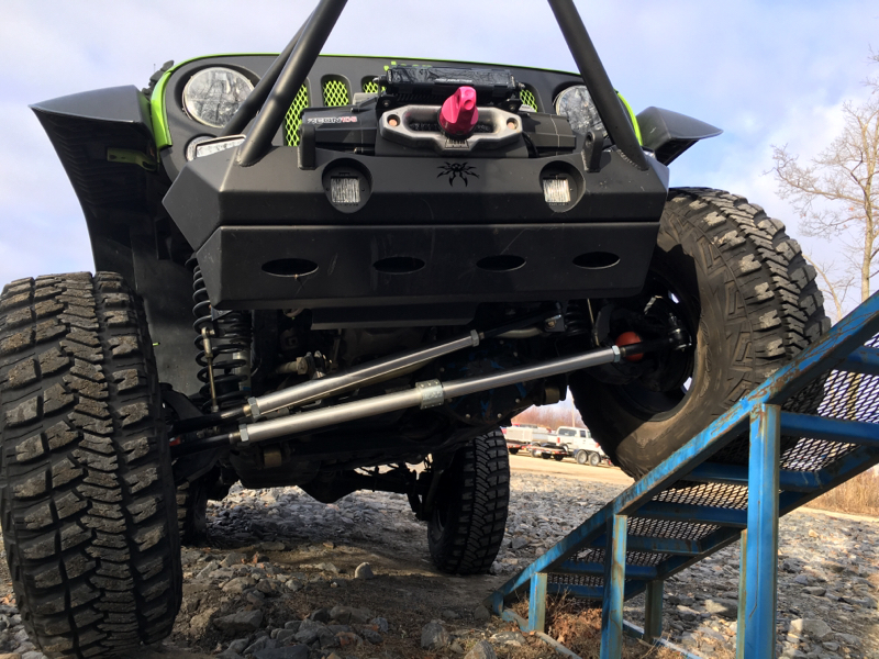

As Fusion mentioned, I'm running their tie rod and drag link with the Poison Spyder diff cover and stock steering stabilizer. Mine is not relocated, but I'm using the 1.75" PSC tie rod clamp.
First I'll say that I'm surprised about your lack of clearance with the stock tie rod, as I had that same setup for years and never felt like the clearance was that tight.
My current setup has zero clearance issues and as you can see, the tie rod clamp is mounted plenty far away from the diff cover, so there are no interference issues even when flexed or turning. The guy that did the other write up also has a PS diff cover but doesn't look like he's running a steering stabilizer or ram yet.
If you are considering an aftermarket tie rod, go with Fusion. Since their setup has hit the market, I see no reason to go with anything else. Even had fellow wheeling buddies ditch other "heavy duty" tie rods in favor of Fusion's.

Any chance you could take a measurement from TR to diff cover with wheel turned? I'm most likely going with the Fusion TR , I want to make sure I have the clearance with my stabilizer relocated.

Yep will do that today and get back to you.
Old May 3, 2016 | 06:11 AM
PsychoCupcake's Avatar
Posts: 710
From: Lexington Park, MD
Okay looks like at full lock there is about 7/8" clearance. Hope that helps. Let me know if you need anything else.
