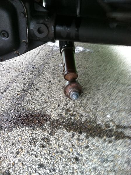

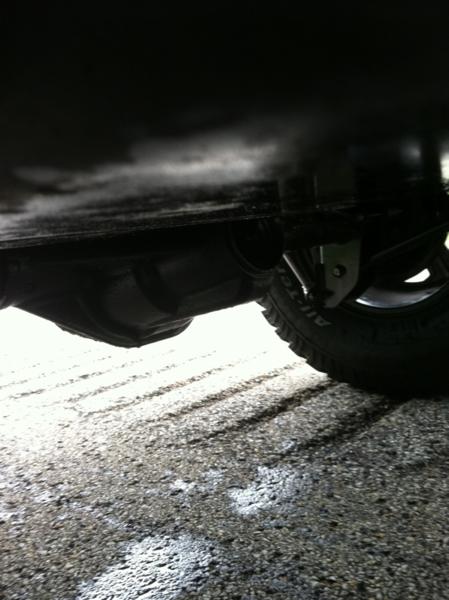

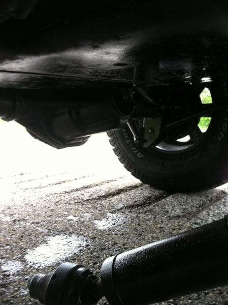

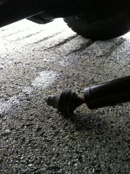

As you can see the pinion gear twisted and broke pulling it out of the rear diff
holy crap, i stand corrected and i'm amazed at what i'm seeing!! yeah, looks like the drive shaft held up and was not the cause of the break but rather, it must have been something inside the diff. at least, that's the only way i can see the pinion breaking like that. something inside the diff clearly locked up fast and hard. quite frankly, i'm surprised that the factory shaft didn't just barber pole as i have seen happen in the past.
x2. At least, if I'm seeing what I think I'm seeing, your installer should be footing the bill for all your new parts.

Oh and there is an ARB in the rear too. Anxious to see how that faired. And no it wasn't locked and the jeep was in 2H
Old May 17, 2011 | 10:03 AM
  #35
ffjeeper's Avatar
Posts: 88
From: Aiken, SC
I'd like to see some pics when the pumpkin gets popped open. Have it towed back to your installer (if you trust them and have a warranty ). By looks of the pics the problem originated in the rearend. Either install error or manufacturer defect in the pinion.
Well, I obviously need a new DS. What would you guys recommend? Should I get rear upper adjustable CA's to adjust pinion angle too?
honestly, there's nothing obvious about it. looking at your pic, your pinion broke at the flange but your shaft looks fine. i would do a physical inspection of it and if all is good, i would just keep using it.
