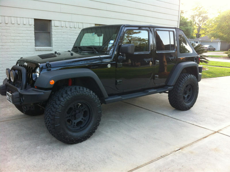

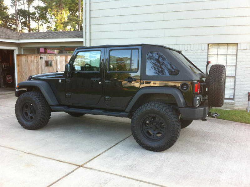

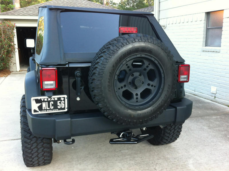

Here are a few more photos...

I just switched the 1-piece Bestop tailgate bar for the 3-piece OEM tailgate bar today. If you have a Trektop NX, I cannot recommend this enough.
The back window is so much easier top open and close with the OEM bar. It just pops in and out of the groove without any prying, but stays firmly in place. I really don't understand why Bestop uses a 1-piece bar. It is way too hard to pull off and on.
