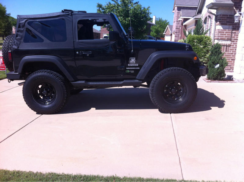

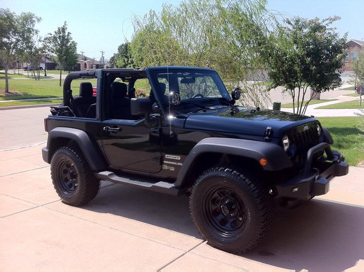

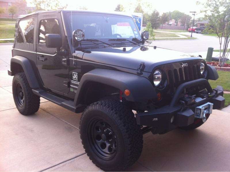

Pic requested. This is 315/70R17 I don't get my spacers till wednesday I wasn't going to get them but I rubbed at full flex on pavement backing out of a space.
I have a pro comp 2.5 lift
Before: this is 275/70R17 no lift
Then after lift same tires
Then last pic is with the 315s
